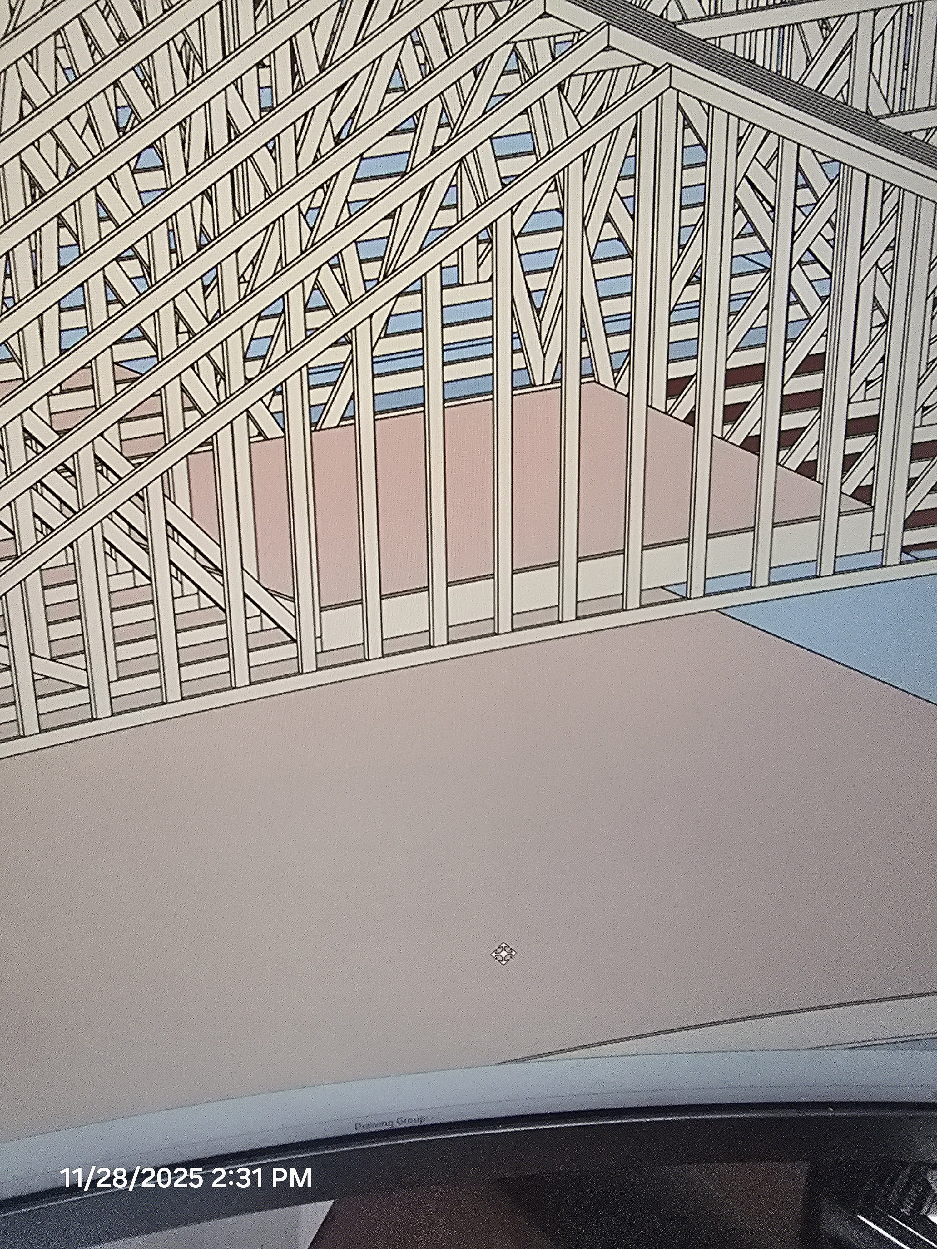

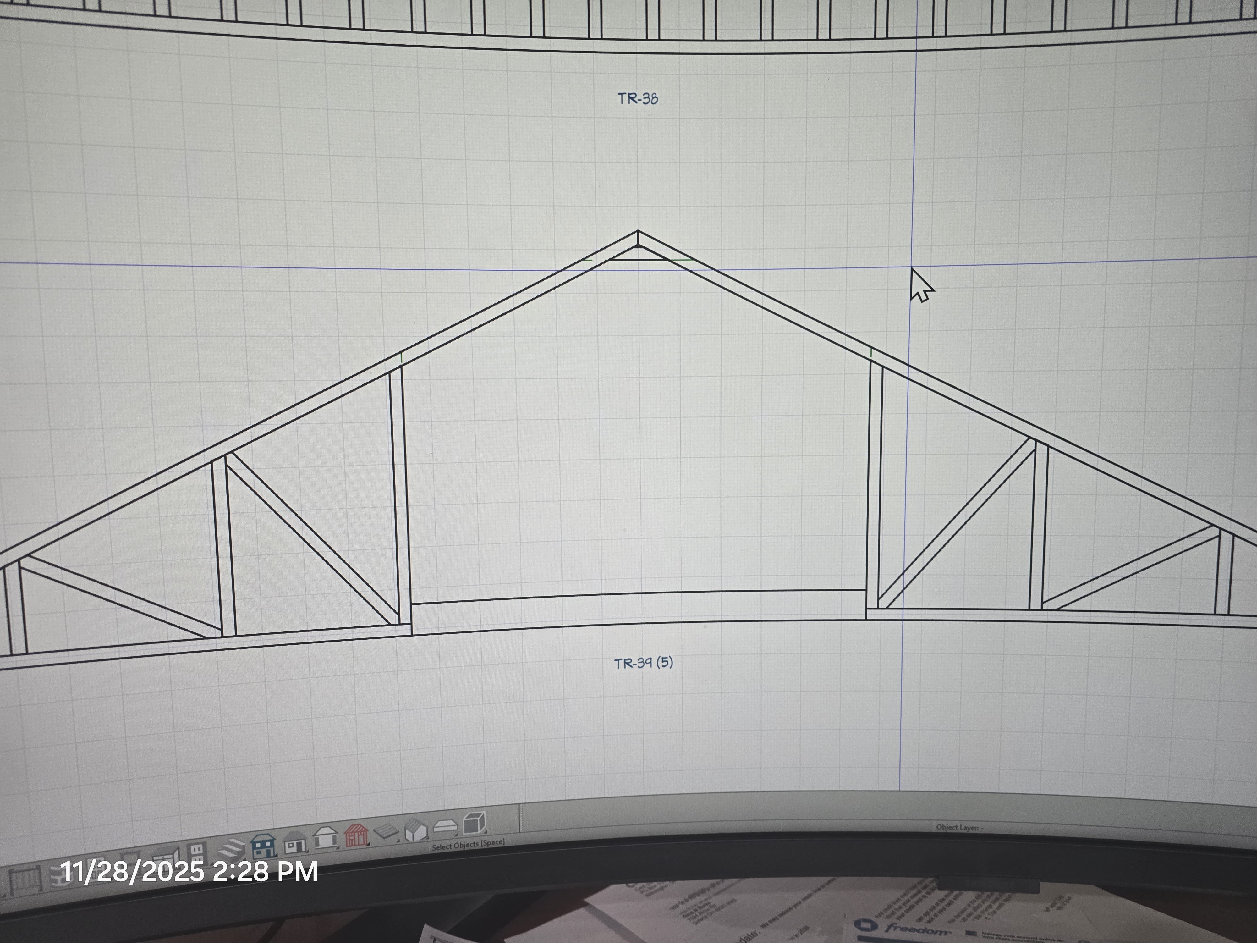

JiAngelo Posted November 28, 2025 Share Posted November 28, 2025 Gene, I happen to be working on a ranch. Here's the steps I followed. Make a blank second floor and specify a ceiling height (97-1/8") and your floor structure (9‐1/4"+3/4"). In Build Roof dbx select ignore Top (2nd) Floor. Draw your room. Select and Open those trusses and select "Attic Truss" Open 3d view and turn on floor surfaces amd you will see the plywood hovering above the bottom chord of a standard room truss. Pick one of those trusses and open truss detail. Break the bottom chord between the attic room ends and increase the middle bottom chord to 9-1/4" Close the truss detail and go back to the 3d view and you will see all the floor trusses should be shown correctly. Hope this helps. Link to comment Share on other sites More sharing options...
