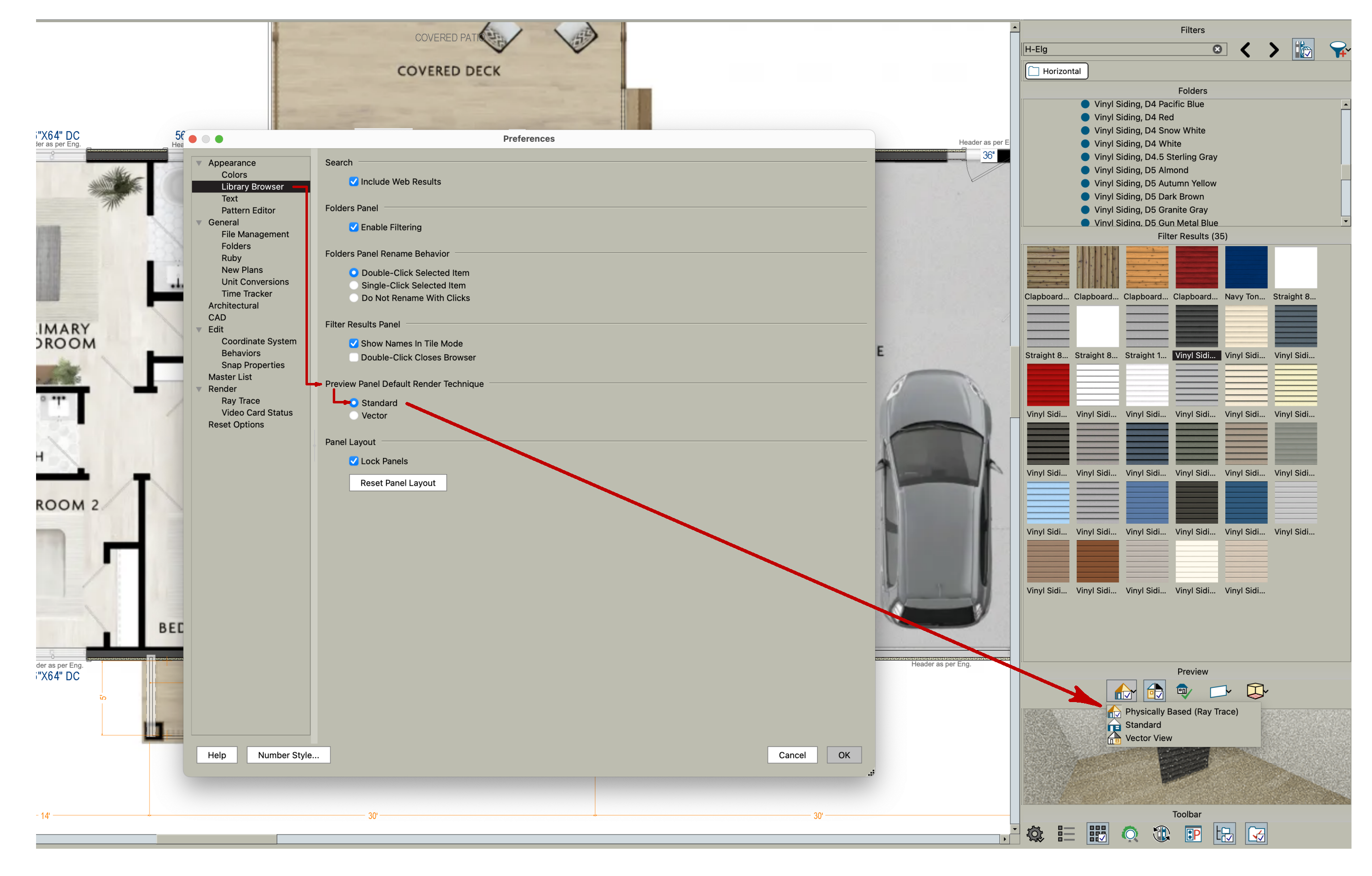

ValleyGuy Posted November 4, 2025 Share Posted November 4, 2025 I updated my computer, which now supports Ray Tracing, and now my library preview wants to default to Ray Trace. I didn't even know that this was an option offered. Is this a bug or is there a way to have it default back to standard? Link to comment Share on other sites More sharing options...
PitMan71 Posted November 4, 2025 Share Posted November 4, 2025 Will chief save your setting if you choose standard in bottom right? Link to comment Share on other sites More sharing options...

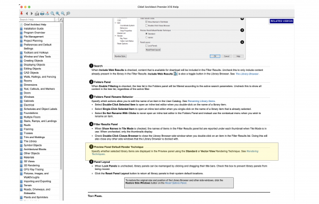

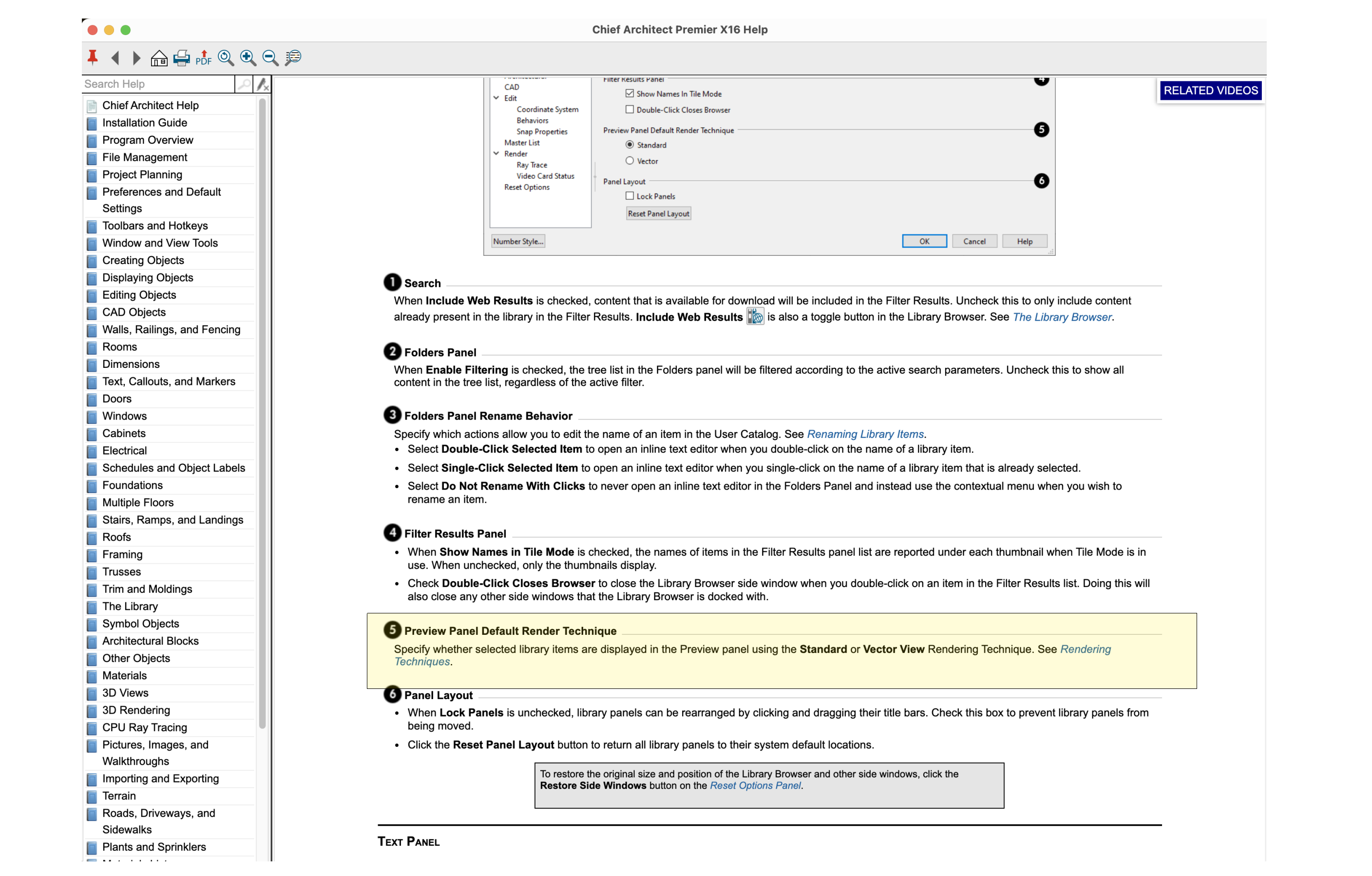

Eric_S Posted November 4, 2025 Share Posted November 4, 2025 Hello, I'm not aware of a way to do this in X16, but X17 has a preference to use Standard on launch. It's located in Preferences -> Appearance -> Dialogs/Side Windows -> Material Previews -> Prefer Physically Based on Launch. Uncheck this to get the behavior you want. 1 Link to comment Share on other sites More sharing options...
ValleyGuy Posted November 4, 2025 Author Share Posted November 4, 2025 37 minutes ago, PitMan71 said: Will chief save your setting if you choose standard in bottom right? It saves the standard setting for the length of that session. When I exit Chief and then relaunch later, it defaults back to Ray Trace. 1 Link to comment Share on other sites More sharing options...
