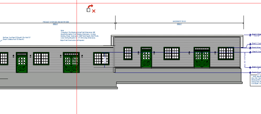

Ed_Orum Posted 9 hours ago Share Posted 9 hours ago Hello, My problem today is mulling a door and a transom. Two of these units (the two on the left in the screenshot) mull without an issue. But the two on the right won't allow me to mull them. Is there a limit to the number of mulled units in a plan? Thanks in advance, Lane Link to comment Share on other sites More sharing options...
robdyck Posted 8 hours ago Share Posted 8 hours ago The 2 transom windows on the right are not on the same floor as the doors. They are in the attic walls on the 2nd Floor. You'll need to copy them down to the floor below and change their elevation reference to 87 1/4" 'From Floor'. Link to comment Share on other sites More sharing options...
