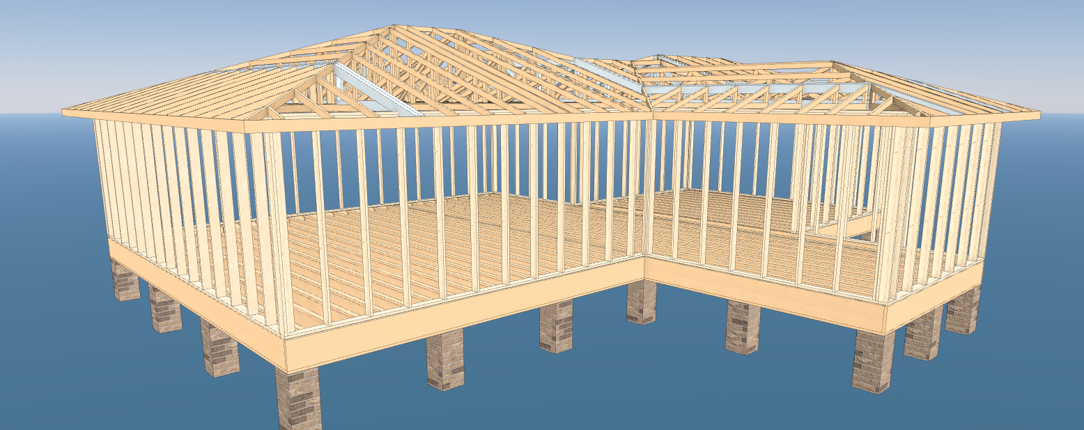

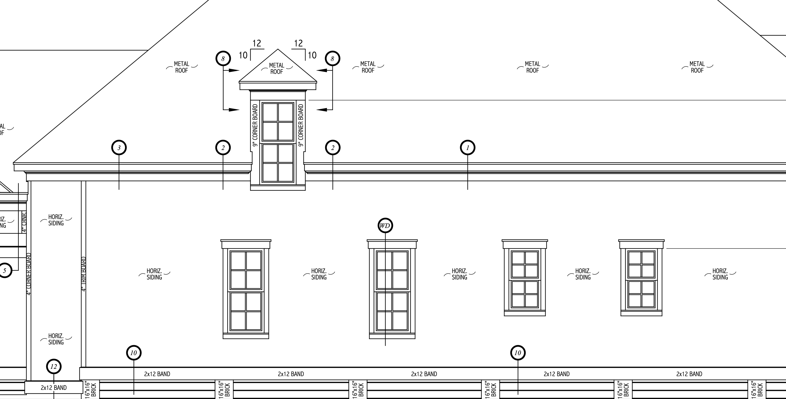

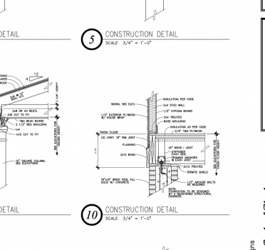

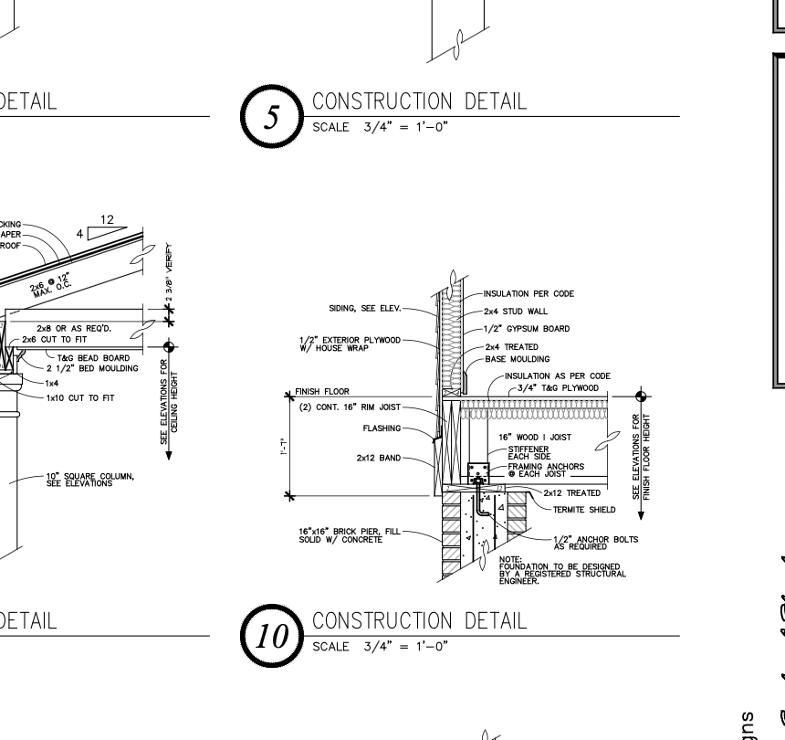

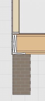

PitMan71 Posted October 8, 2025 Share Posted October 8, 2025 (edited) I have a project coming up that the foundation is brick piers as shown in the attached images. What is the best way to draw these the way they are shown here? I have looked at the foundation tool with piers but it centers them under the edge of the wall and it doesn't appear they can be moved. Anyway, I will probably be doing a few like this so I want to get it figured out. Thank in advance for tips on this. Edited October 8, 2025 by PitMan71 Link to comment Share on other sites More sharing options...

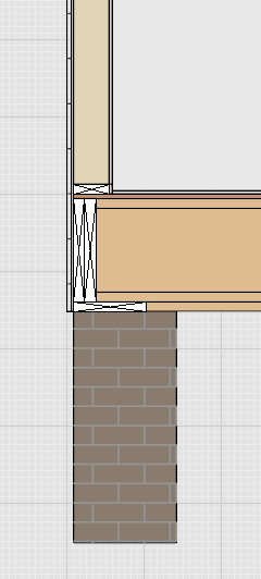

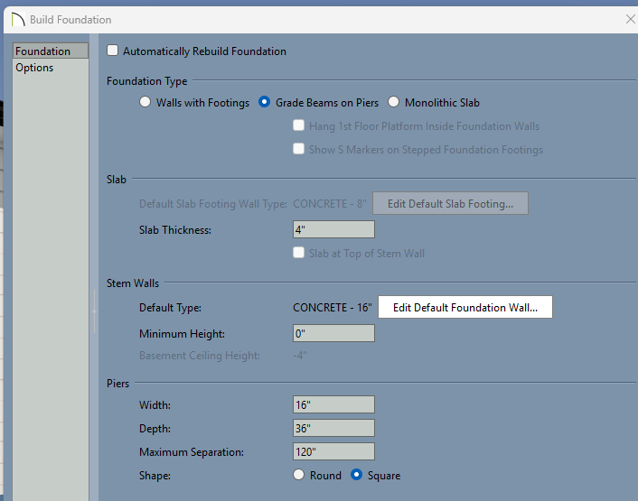

Solution robdyck Posted October 8, 2025 Solution Share Posted October 8, 2025 (edited) The actual wall type doesn't really matter when the foundation height is 0", but a 16" wide foundation wall gets the piers aligned correctly. I 'painted' the piers instead of changing the default material for the foundation/slab. The pier spacing I used is simply an example. Everything here is automatic. Edited October 8, 2025 by robdyck 1 Link to comment Share on other sites More sharing options...
PitMan71 Posted October 9, 2025 Author Share Posted October 9, 2025 Thanks.... Im gonna go try this now. 1 Link to comment Share on other sites More sharing options...
