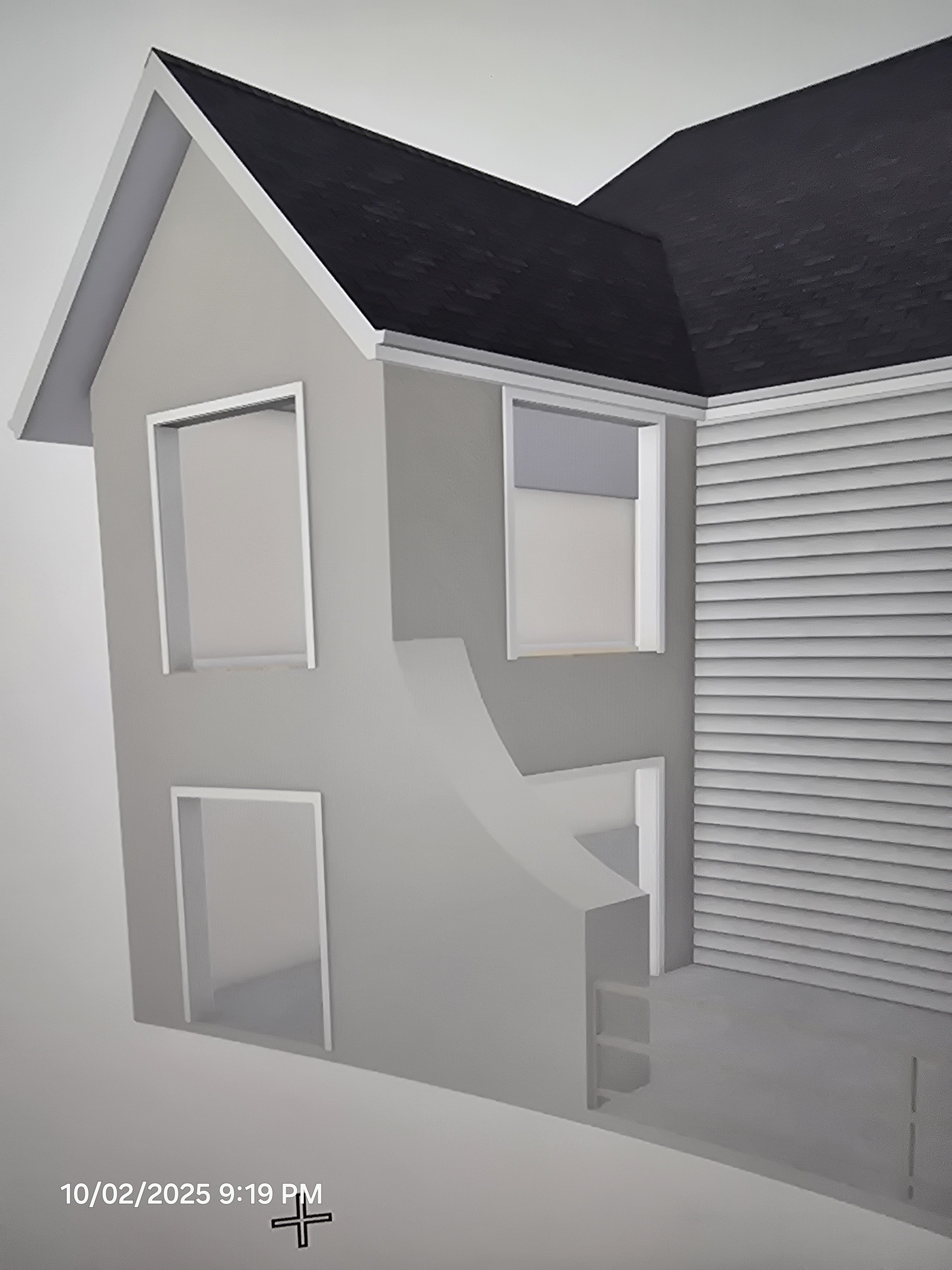

Jakereinhardt55 Posted October 2 Share Posted October 2 Hey guys, does anyone know a good way to get this flared wall effect. I tried using a pass-through that I would hide but it wont go pasted the end of the wall. I also tried just using a 3d solid but that looks sloppy in the elevation when you attach it to the wall. Link to comment Share on other sites More sharing options...

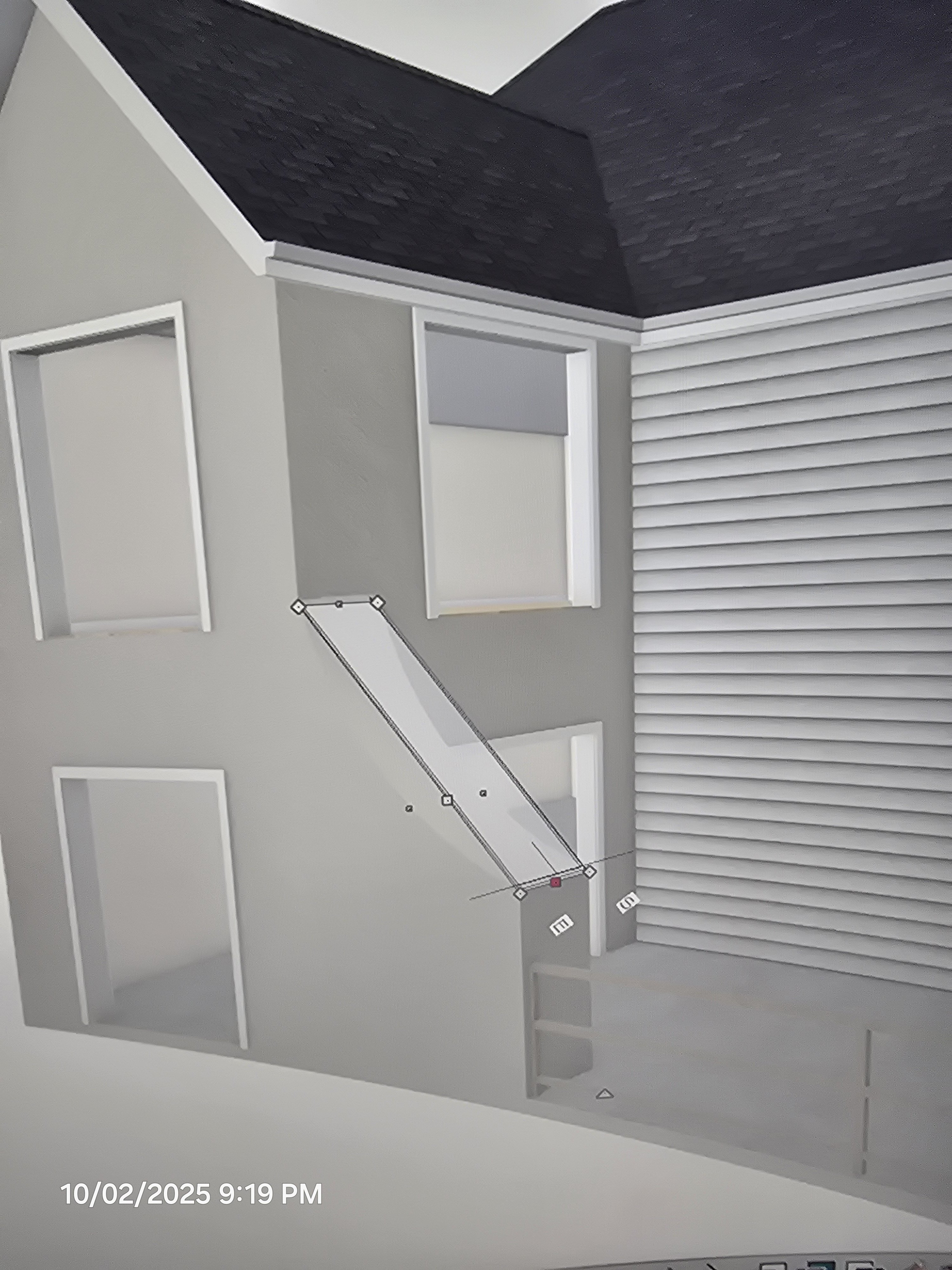

JiAngelo Posted October 3 Share Posted October 3 (edited) Using walls create a 3' high room under the curve. Specify a gable roof at a slope that meets the entry wall where you want the curve to end. Strip down the roof plane with 0" overhangs and eaves. Then specify the curve and change roof plane materials to match your exterior finish. You will need auto roofs turned off to change the roofing material. Edited October 3 by JiAngelo Add images Link to comment Share on other sites More sharing options...
