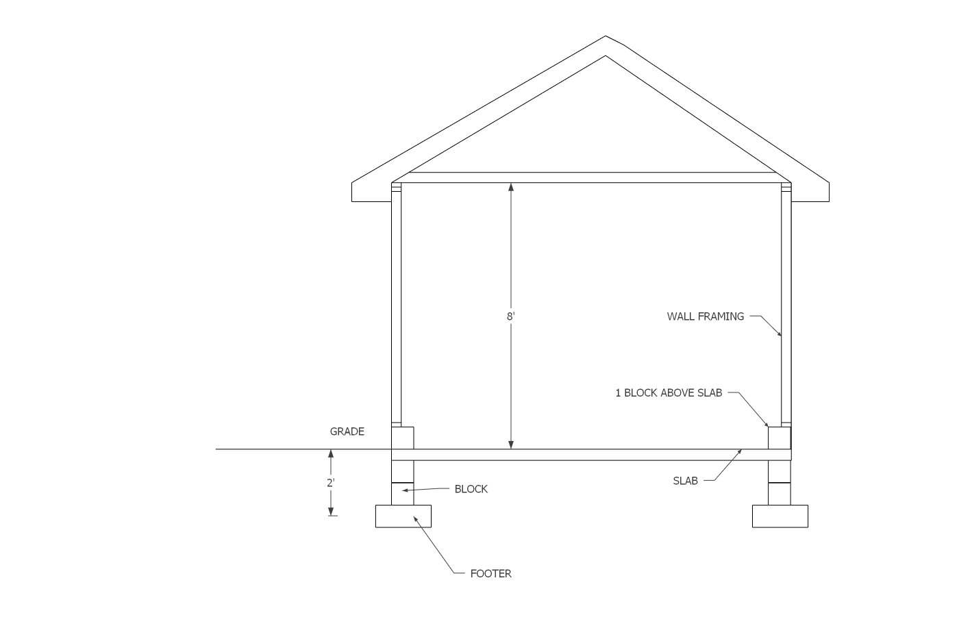

thomhu Posted October 1 Share Posted October 1 This one is giving me issues. I've been RTFM and youtubing but not having success. I could use some your fine folks' expertise..... What is the most efficient way to go through the dialogue boxes add a foundation for a shed with the details in the attached sketch? It's a slab on a footer and two rows of blocks. Then a single block on top of the slab with pins to get the shed an additional 8" off the ground with the wall on top. When I get into the foundation dialogue box , there are options for stem walls and monolithic pour, but I'm not getting the right combo. Any help would be much appreciated. Chief x17 Win 11 RTX 5070 graphics card IBM think station Link to comment Share on other sites More sharing options...
Joe_Carrick Posted October 1 Share Posted October 1 Use a Pony Wall for the CMU on top of the slab. 1 Link to comment Share on other sites More sharing options...
thomhu Posted October 1 Author Share Posted October 1 Thanks much! I couldn't recognize such a short pony..... Link to comment Share on other sites More sharing options...
Joe_Carrick Posted October 1 Share Posted October 1 5 minutes ago, thomhu said: Thanks much! I couldn't recognize such a short pony..... It's technically a "Lower Wall Type" vs "Upper Wall Type". I wish CA was consistent in naming these things. Link to comment Share on other sites More sharing options...
