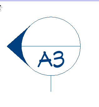

creatrix Posted September 29, 2025 Share Posted September 29, 2025 Can someone explain to me how to get rid of the small line seen going perpendicular to the callout arrow? thanks in advance! Link to comment Share on other sites More sharing options...
DBCooper Posted September 29, 2025 Share Posted September 29, 2025 Uncheck "cross section line" on the "attributes" page of the callout dialog. If that doesn't make it go away, then post the plan. Link to comment Share on other sites More sharing options...
creatrix Posted September 29, 2025 Author Share Posted September 29, 2025 You're my hero! Thanks again. Link to comment Share on other sites More sharing options...
