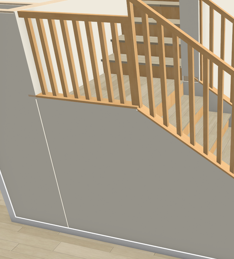

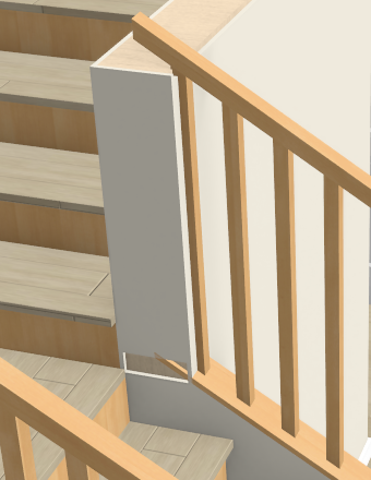

StephenM Posted September 20, 2025 Share Posted September 20, 2025 (edited) Hi, Got a couple questions regarding railing rake walls. What is causing my railing rake wall on the right of the stairs to run into the middle of the perpendicular wall it meets at? The same thing is also happening with the rake wall on the left side of the landing, meeting a normal wall. What is the best way to get an angled rake wall following stairs to transition into a flat rake wall beside the landing? Attached are photos and the plans. TIA Plans.plan Edited September 20, 2025 by StephenM Link to comment Share on other sites More sharing options...
Mark3D Posted September 21, 2025 Share Posted September 21, 2025 See if that is better it still needs a bit of cleaning up, other may have a better way to do it Plans.plan Link to comment Share on other sites More sharing options...
