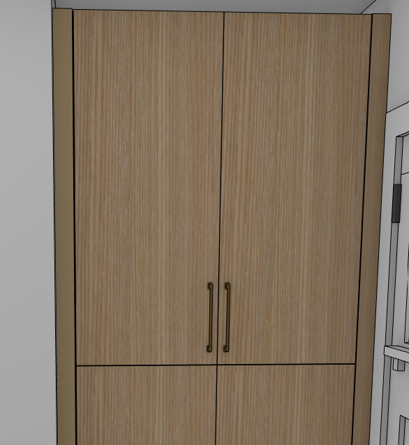

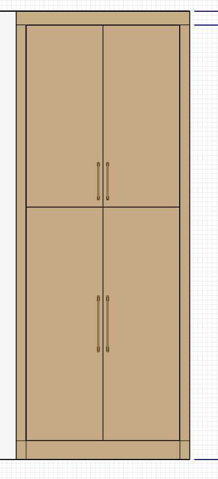

JordanWeed Posted September 9, 2025 Share Posted September 9, 2025 I have a wood material that works perfectly in the 3d camera, however in the elevation it appears as a solid color. Is there any way to change so elevation shows pattern? I do have "Patterns, 3D Views" turned on. Link to comment Share on other sites More sharing options...

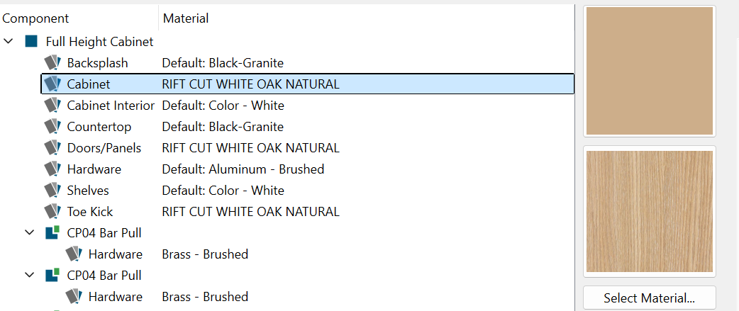

DBCooper Posted September 9, 2025 Share Posted September 9, 2025 Your material needs to have a pattern for the pattern to show up. You can actually generate one from the texture using the "define material" dialog but these might take some tweaking to make look ok. You can also assign one of the pre-made ones. Personally, I find wood grain patterns way too busy for elevation views. Here is a training video that might help, but there are lots of other videos and articles about this stuff: https://www.chiefarchitect.com/videos/watch/259/creating-and-editing-custom-patterns.html Link to comment Share on other sites More sharing options...

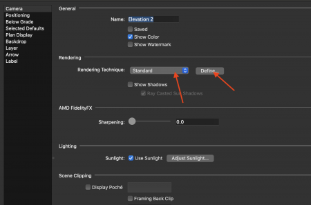

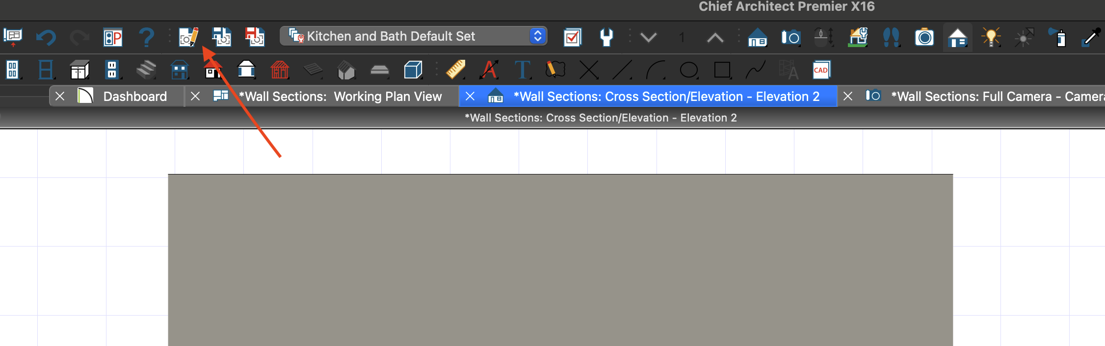

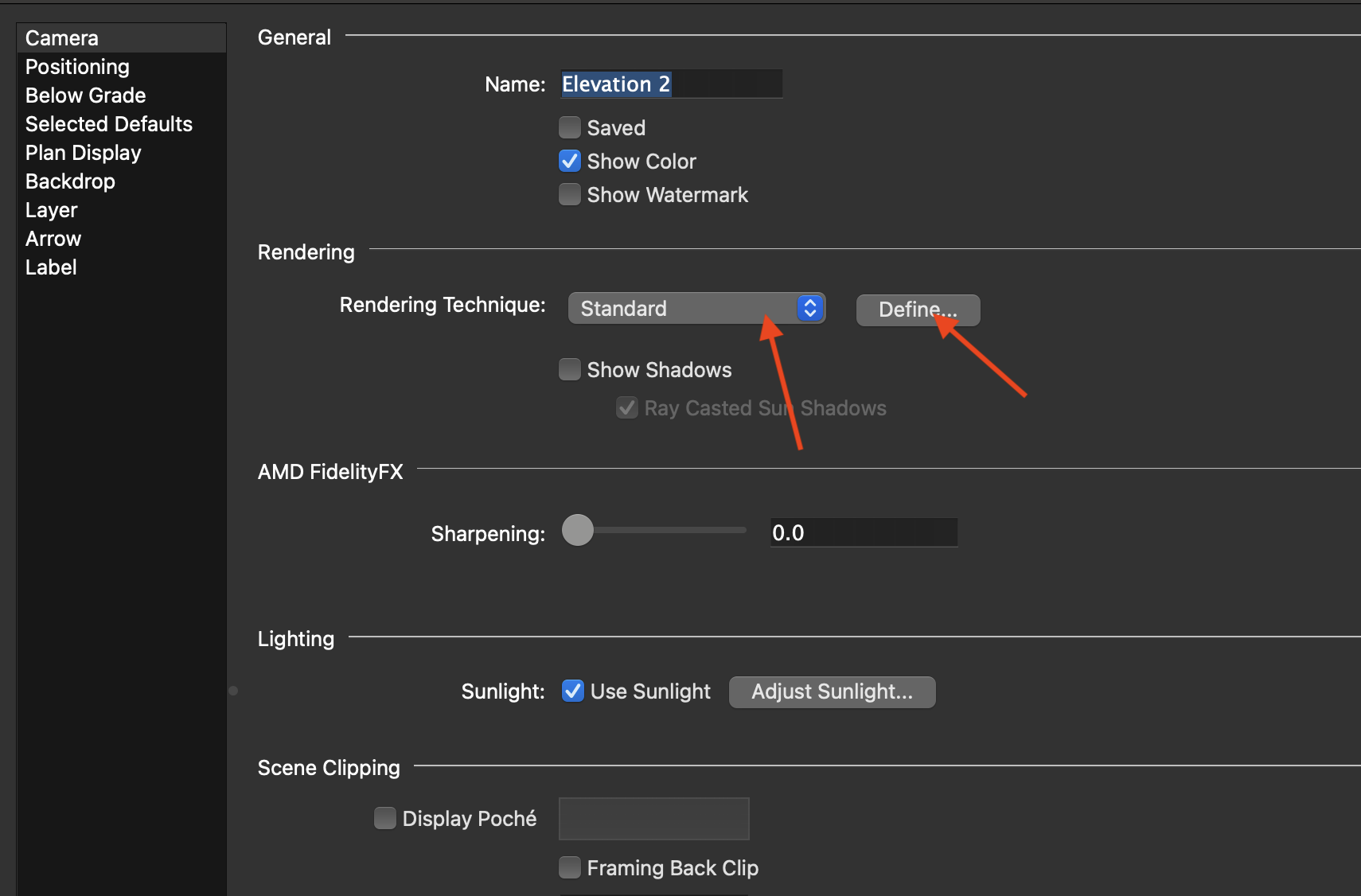

PitMan71 Posted September 9, 2025 Share Posted September 9, 2025 You can change your rendering technique in that view to standard and update the standard view to add lines. Ince in the view, click on the edit box. Then once in the dbx change the rendering technique. Lastly, click "define" to add lines.... Probably want to pull the squiggle values down so that they dont look hand drawn. Link to comment Share on other sites More sharing options...
