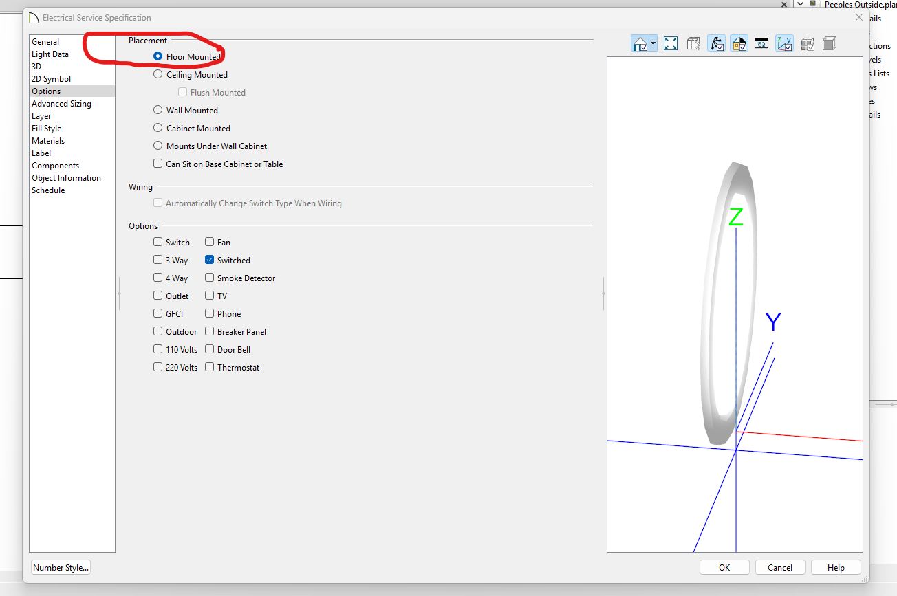

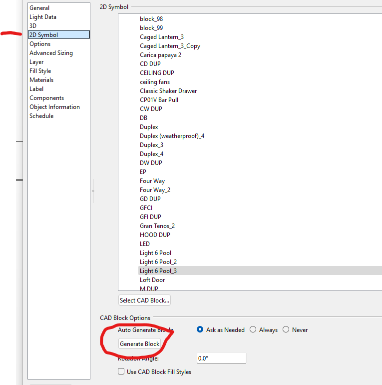

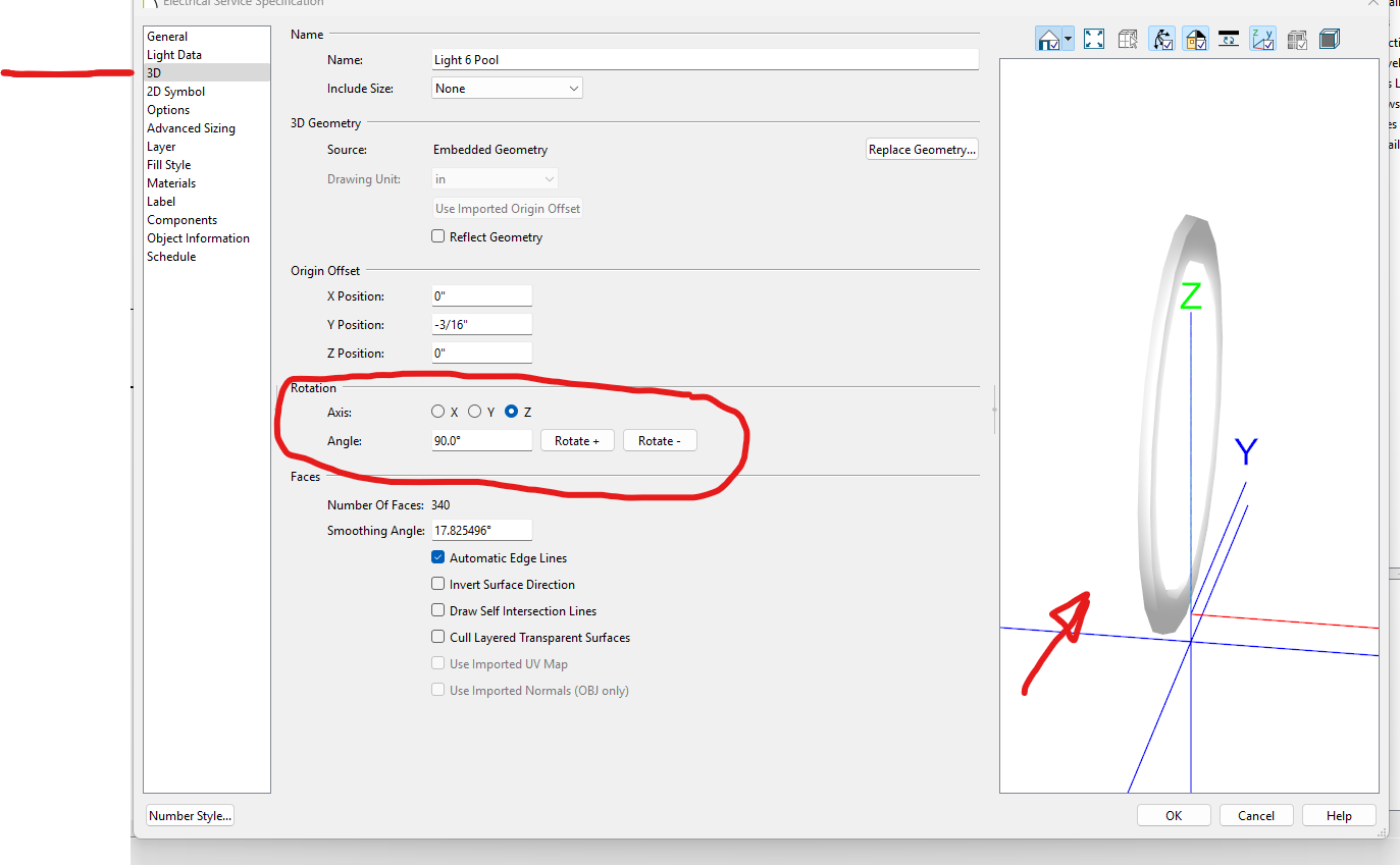

mtldesigns Posted September 8, 2025 Share Posted September 8, 2025 (edited) 47 minutes ago, rcapone said: Are there lights for pools I made my own, by copying a 6" recess light to my user catalog then renamed it so I knew what kind of light it was. "Open Object" that part in your user catalog. Go to the 3D tab, and rotate this fixture, I believe on the Y axis +90 degrees Then go to the Options and make this floor mounted. (I could never get this to work as wall mounted, even though that is my preferred method) Lastly, go to the 2D Symbol tab, and at the bottom of that page is "Generate Block". This will put the light in the vertical. Place the light on your pool wall, adjust the height A/R. Recording 2025-09-07 201845.mp4 Edited September 8, 2025 by mtldesigns 1 1 Link to comment Share on other sites More sharing options...
rcapone Posted September 9, 2025 Author Share Posted September 9, 2025 Thanks, I have CA 13 so unfortunately I don't have the options you do. But I did an elevation and rotated 90 degrees and it worked. Didn't think about that initially but once I saw what you did I gave it a try. Thanks a mil. Now I just need to understand the light properties lol. Link to comment Share on other sites More sharing options...

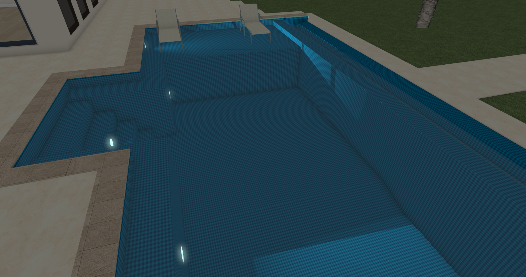

rcapone Posted September 9, 2025 Author Share Posted September 9, 2025 This is how it came out. Link to comment Share on other sites More sharing options...
