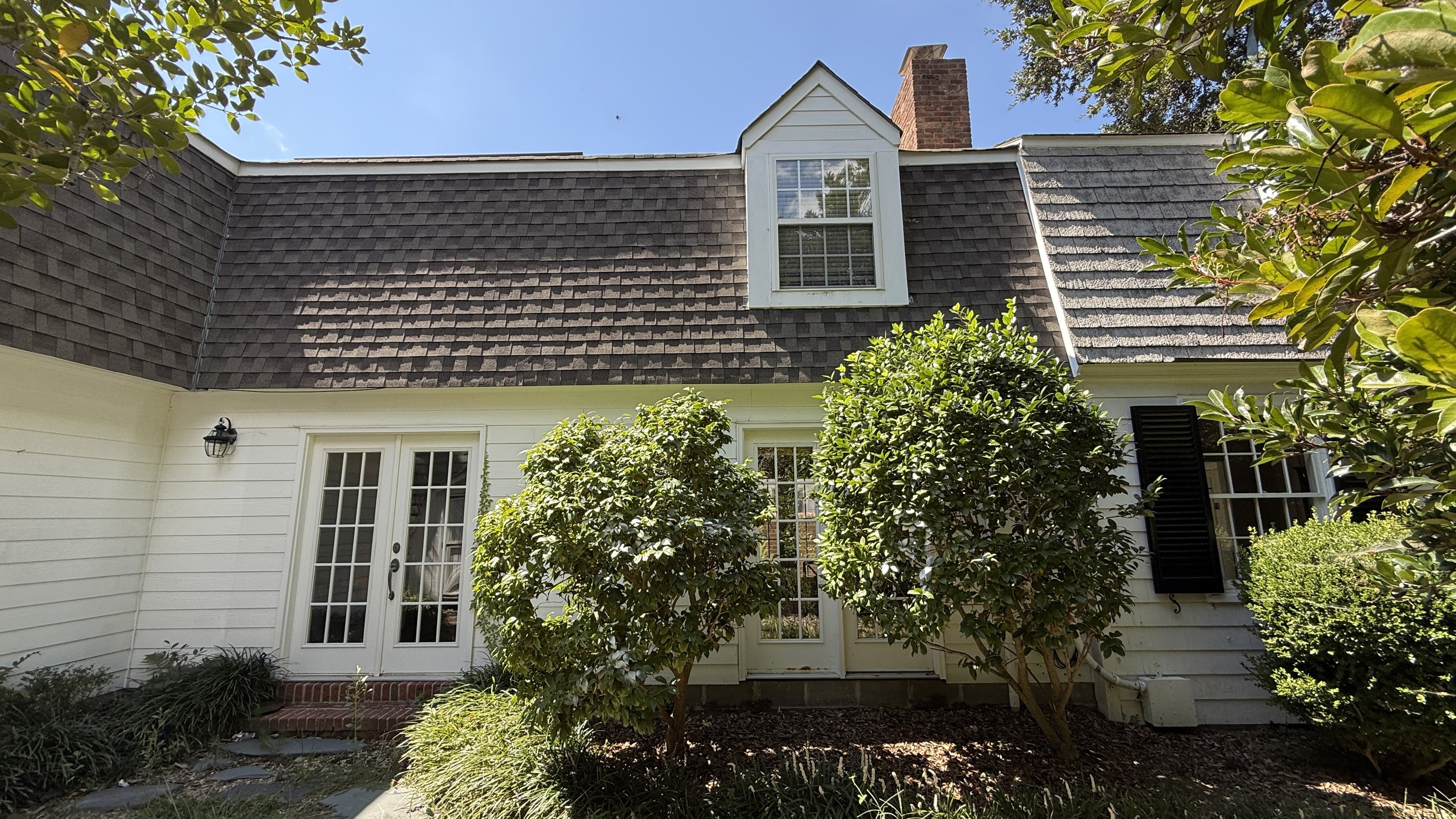

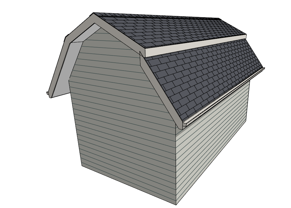

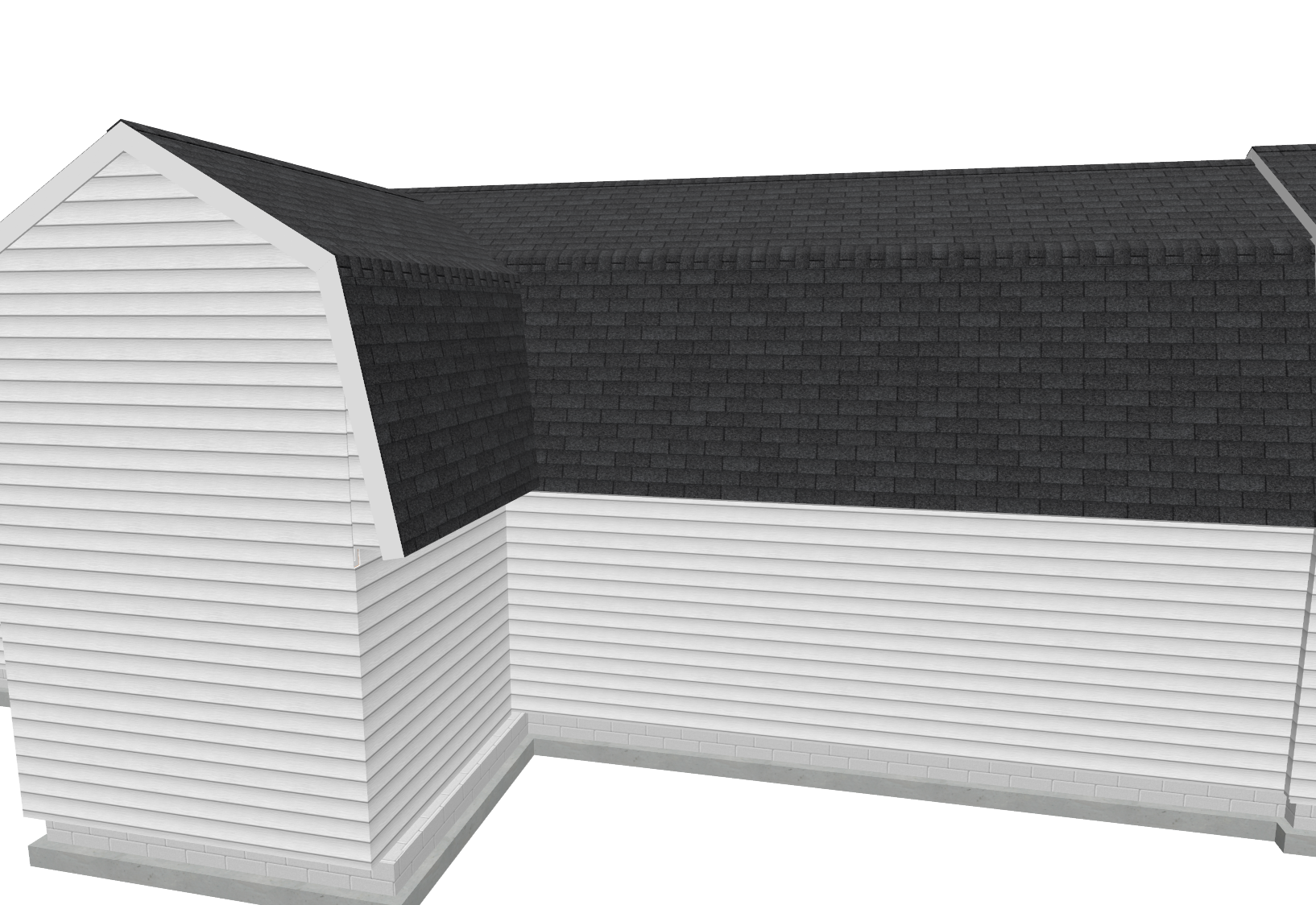

Ringos Posted September 7, 2025 Share Posted September 7, 2025 I need the roof ridge where the two roofs join to be fascia like the picture. I am not sure how to accomplish this. Would I change the roof ridge in settings to a facia like material? Link to comment Share on other sites More sharing options...
PitMan71 Posted September 7, 2025 Share Posted September 7, 2025 My guess is if you if you grab that edge of the upper roof and pull it out beyond the upper edge of the lower roof its should give you the look you are after. This will break the automatic roof, but I am pretty sure that is the only way to pull that off. Link to comment Share on other sites More sharing options...
DBCooper Posted September 7, 2025 Share Posted September 7, 2025 I don't know if there is an easy way to do this. You might want to try just pulling the lower side of the top roof plane down and then turn off the gutter. Link to comment Share on other sites More sharing options...
