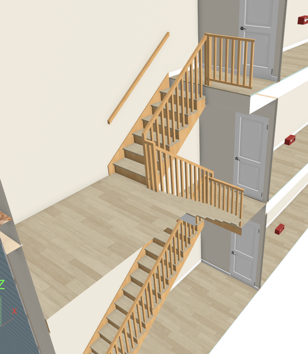

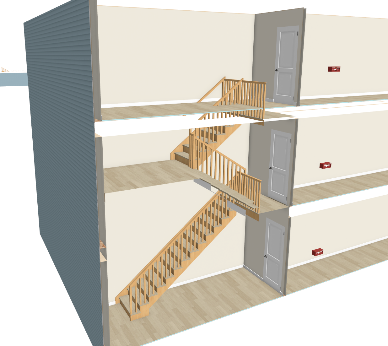

StephenM Posted September 3, 2025 Share Posted September 3, 2025 I'm trying to re-create stairs in a stairwell of an 3 story apartment building. Not to sure what the best way to go about this is, as I've tried using U shaped stairs and laying each set of stairs and landing individually, but have had no luck getting all of them to connect. There is a landing between the 2nd and 3rd floor. I've attached a couple photos for reference. I do have a video but it is to large to attach. T.I.A IMG_6793.HEIC IMG_6792.HEIC Plans.plan Link to comment Share on other sites More sharing options...

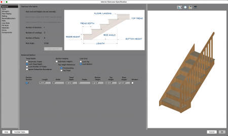

Michael_Gia Posted September 3, 2025 Share Posted September 3, 2025 (edited) Just draw your stairs individually from landing to landing. Here I just edited the staircase that you had drawn spanning both floors. I opened the dialogue box for the stair. - Uncheck automatic heights - Lock bottom (or top) just make sure you know the height of your landing before hand. - Set to 7 steps and adjust height of riser to fall on landing. Edited September 3, 2025 by Michael_Gia Link to comment Share on other sites More sharing options...

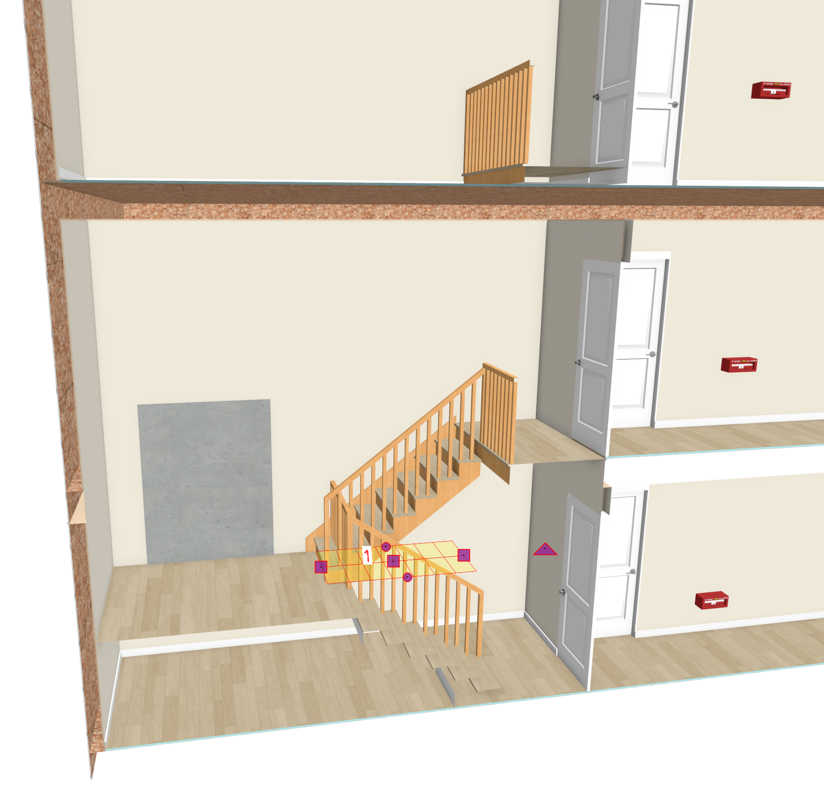

StephenM Posted September 3, 2025 Author Share Posted September 3, 2025 (edited) 1 hour ago, Michael_Gia said: Just draw your stairs individually from landing to landing. Here I just edited the staircase that you had drawn spanning both floors. I opened the dialogue box for the stair. - Uncheck automatic heights - Lock bottom (or top) just make sure you know the height of your landing before hand. - Set to 7 steps and adjust height of riser to fall on landing. When I attempt this, the first long set of stairs to the 2nd floor landing work but then the the railing on the landing stays where the next set of stairs go up to the landing between the 2nd and 3rd floor and 3rd floor landing. Not sure what is causing that as I followed what you had recommended. Edited September 3, 2025 by StephenM Link to comment Share on other sites More sharing options...
Rookie65 Posted September 3, 2025 Share Posted September 3, 2025 The landing and stair run are likely not connected properly. Check the height of the landing and top of stair run dimensions Link to comment Share on other sites More sharing options...
StephenM Posted September 4, 2025 Author Share Posted September 4, 2025 3 hours ago, Rookie65 said: The landing and stair run are likely not connected properly. Check the height of the landing and top of stair run dimensions No luck still, I've played around with rise and tread numbers and nothing seems to connect them properly still. Even using numbers not true to what site is. Link to comment Share on other sites More sharing options...
StephenM Posted September 4, 2025 Author Share Posted September 4, 2025 Still not sure why the stairs from the second floor to the landing between the 2nd & 3rd floor won't recognize. Link to comment Share on other sites More sharing options...
Michael_Gia Posted September 8, 2025 Share Posted September 8, 2025 (edited) On 9/4/2025 at 11:31 AM, StephenM said: Still not sure why the stairs from the second floor to the landing between the 2nd & 3rd floor won't recognize. Don't try and "connect" When you select a stair section, press SHIFT + select, to select only 1 section at a time. 1) uncheck "automatic heights" 2) choose "lock bottom 3) enter the bottom and top height (in that order). The riser height will adjust automatically. Edited September 8, 2025 by Michael_Gia Link to comment Share on other sites More sharing options...
