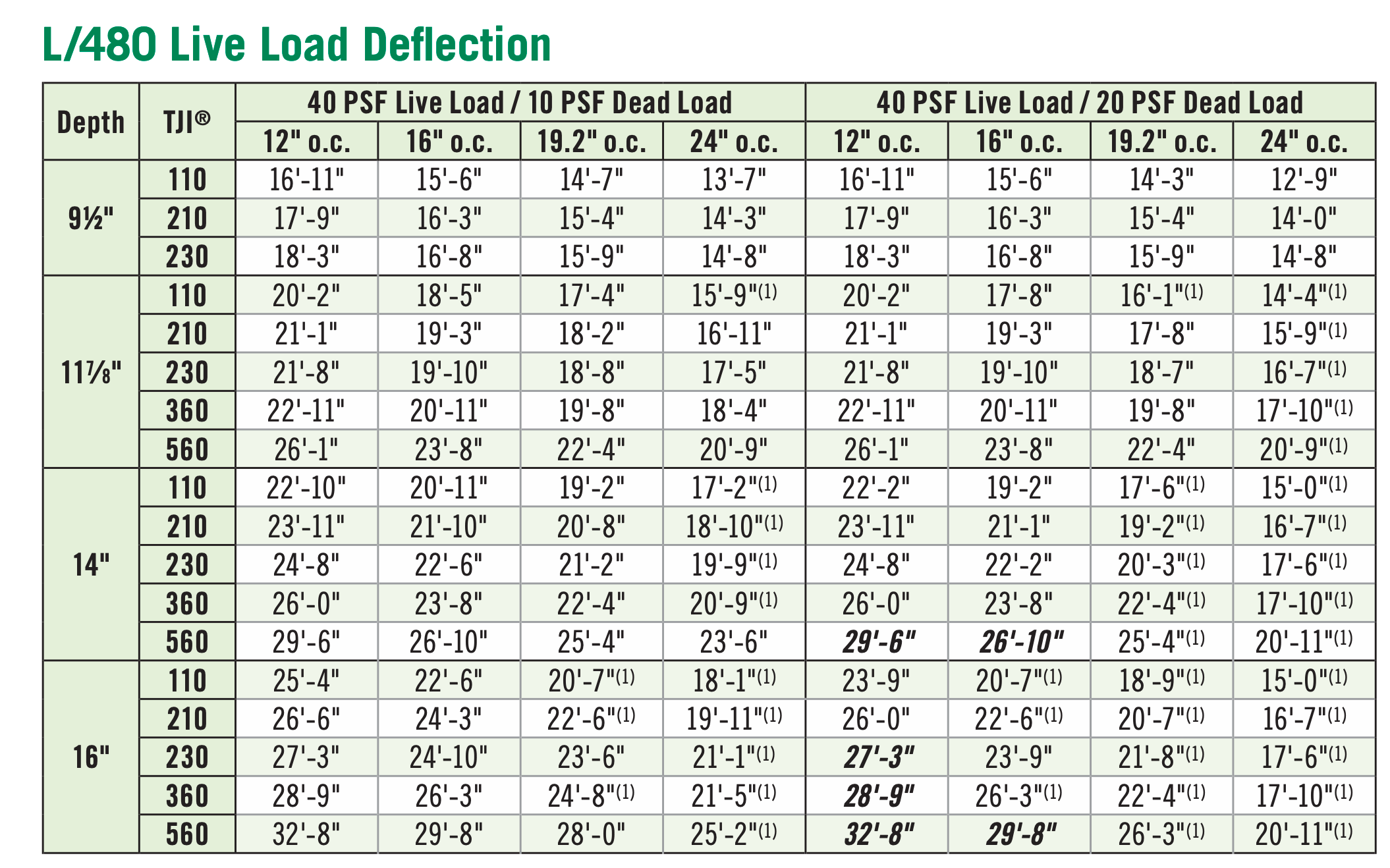

para-CAD Posted September 11, 2025 Share Posted September 11, 2025 easy PE can specify a diaphragm ceiling...14" l/480 TJI 560s Link to comment Share on other sites More sharing options...
decorators3 Posted September 12, 2025 Author Share Posted September 12, 2025 On 9/11/2025 at 12:15 AM, para-CAD said: easy PE can specify a diaphragm ceiling...14" l/480 TJI 560s thank you - appreciated,, Link to comment Share on other sites More sharing options...

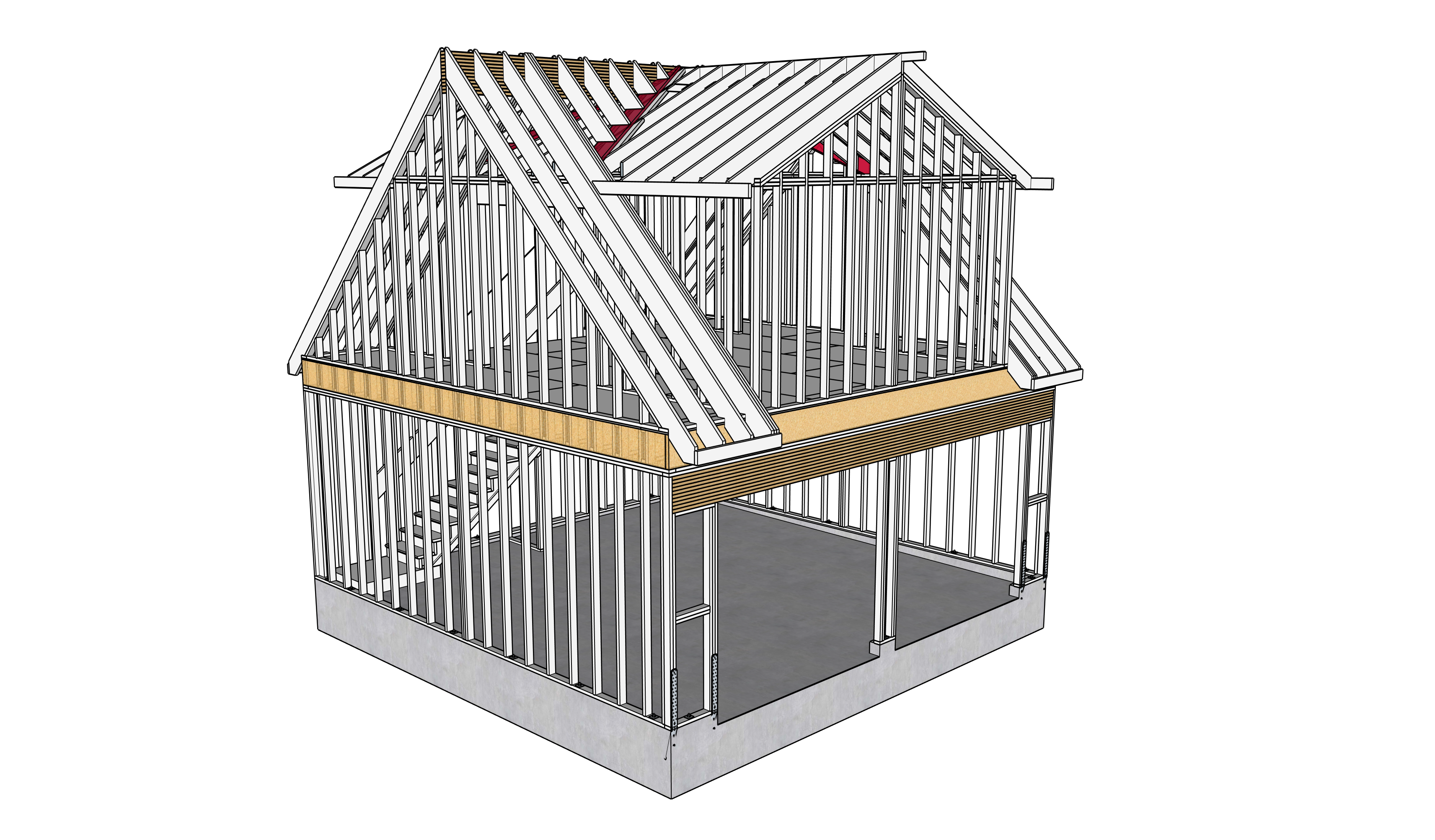

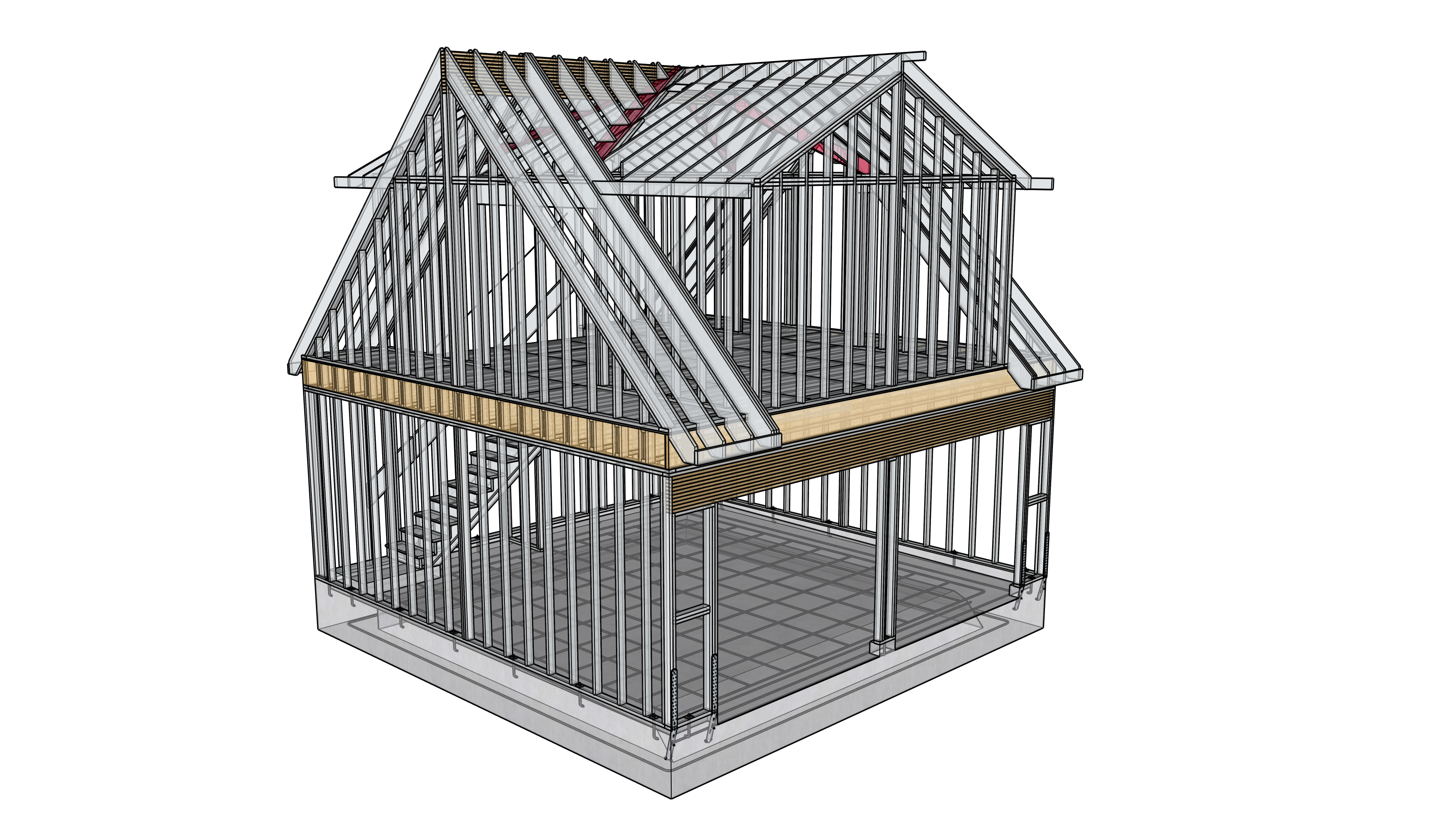

decorators3 Posted September 12, 2025 Author Share Posted September 12, 2025 On 9/9/2025 at 1:24 AM, para-CAD said: You might get some ideas from this model......free SU can open it https://www.dropbox.com/scl/fi/frwnjkh8gsg1je8uizn6p/Garage-Model.skp?rlkey=sqqif892fhs51sacpra1m3mth&dl=0 On 9/9/2025 at 1:24 AM, para-CAD said: You might get some ideas from this model......free SU can open it https://www.dropbox.com/scl/fi/frwnjkh8gsg1je8uizn6p/Garage-Model.skp?rlkey=sqqif892fhs51sacpra1m3mth&dl=0 this looks good . the only difference in what I'm doing is the 24 x 16 is not in the center but on the far left side to accommodate full wall windows. with small windows front and back. extra 8ft space to the right will be attic space. I don't have SU and have never used it, 1 Link to comment Share on other sites More sharing options...
