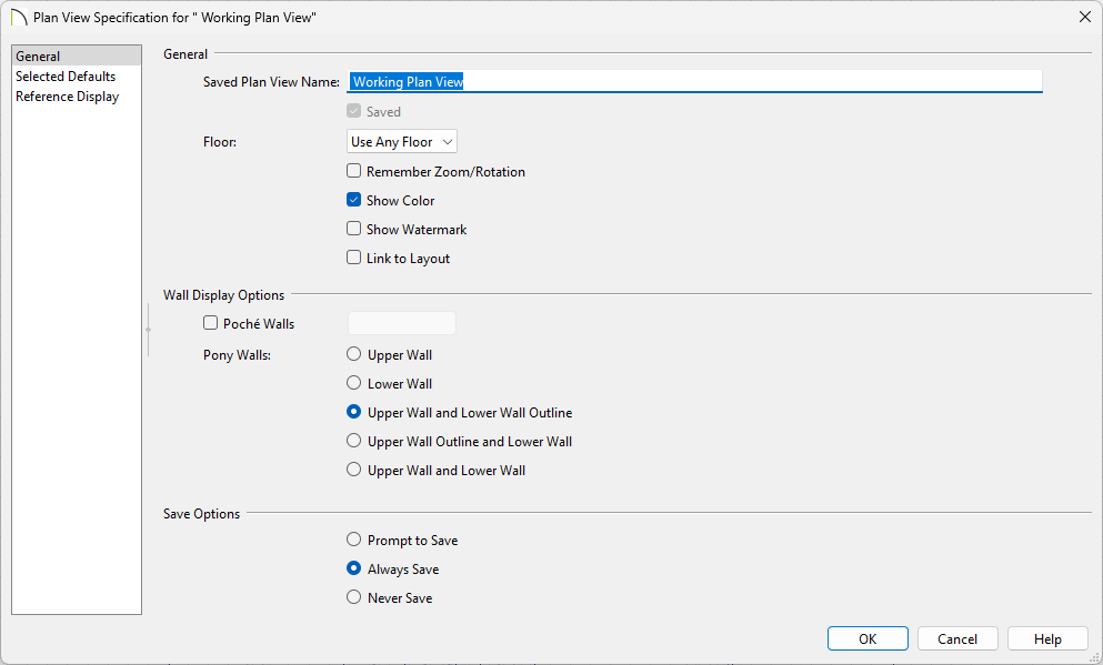

Skip_D Posted September 1, 2025 Share Posted September 1, 2025 Hi, Using Pony walls at the basement level. Normally I like to show the upper wall normal w/ the lower wall outlined. However, for the foundation guy on the foundation layout sheet he just wants to see the foundation w/out the clutter of the upper wall. I have to imagine this is doable ... can someone send me down the right path on this? thanks, george X16 Link to comment Share on other sites More sharing options...
DBCooper Posted September 2, 2025 Share Posted September 2, 2025 Take a look at the settings in the saved plan view dialog. You can change the pony wall settings for any saved plan view so you just need to setup a different one for the basement than the other floors. Link to comment Share on other sites More sharing options...
