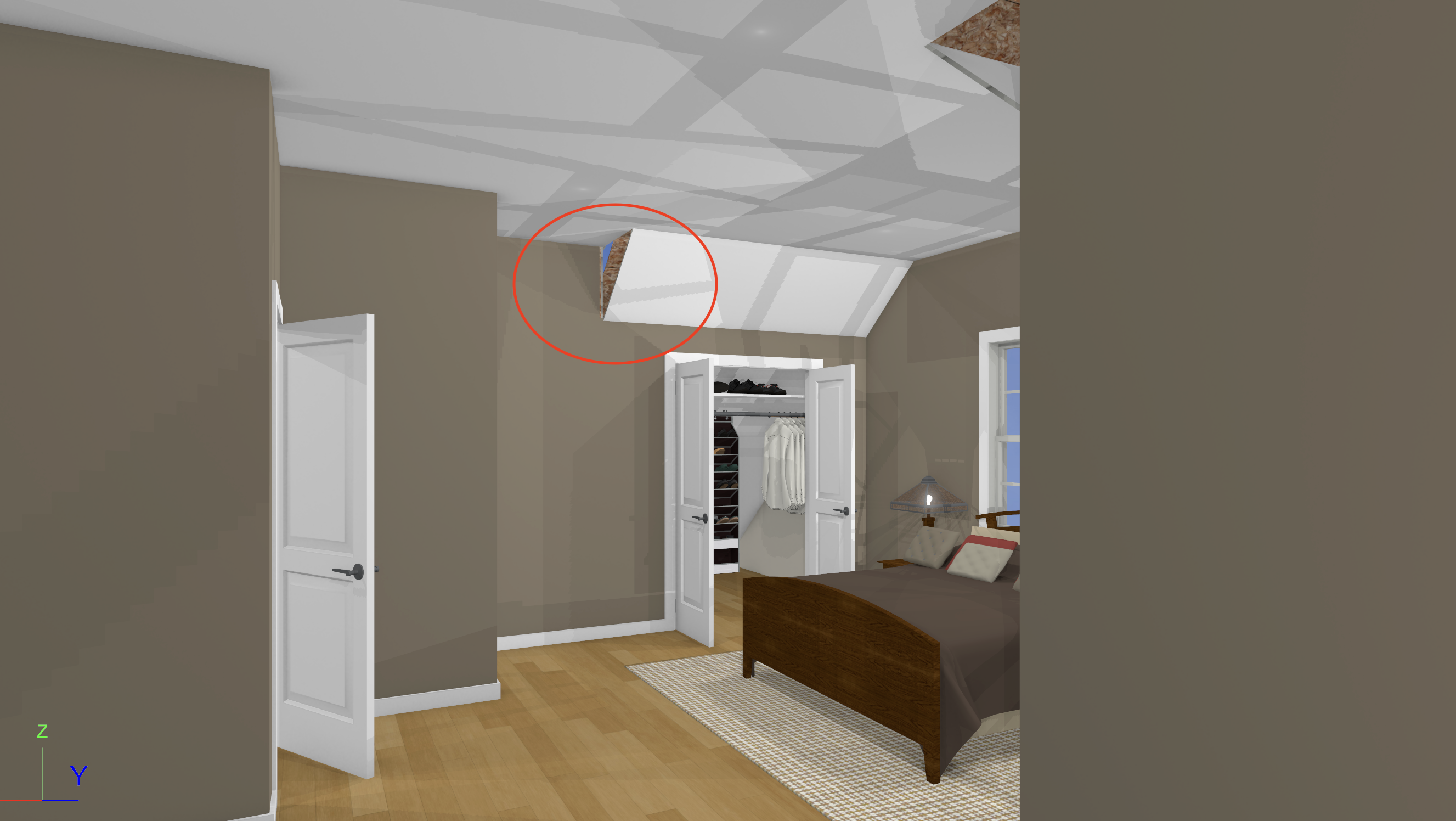

cliffy Posted Monday at 04:58 PM Share Posted Monday at 04:58 PM Can anyone shed some light as to how to fix this? Link to comment Share on other sites More sharing options...
ericepv Posted Monday at 06:05 PM Share Posted Monday at 06:05 PM Check your roof planes around the dormer, make sure that they are not cutting into the wall. 1 Link to comment Share on other sites More sharing options...
cliffy Posted Monday at 06:51 PM Author Share Posted Monday at 06:51 PM Thanks, I have exhausted all obvious attempts. Link to comment Share on other sites More sharing options...

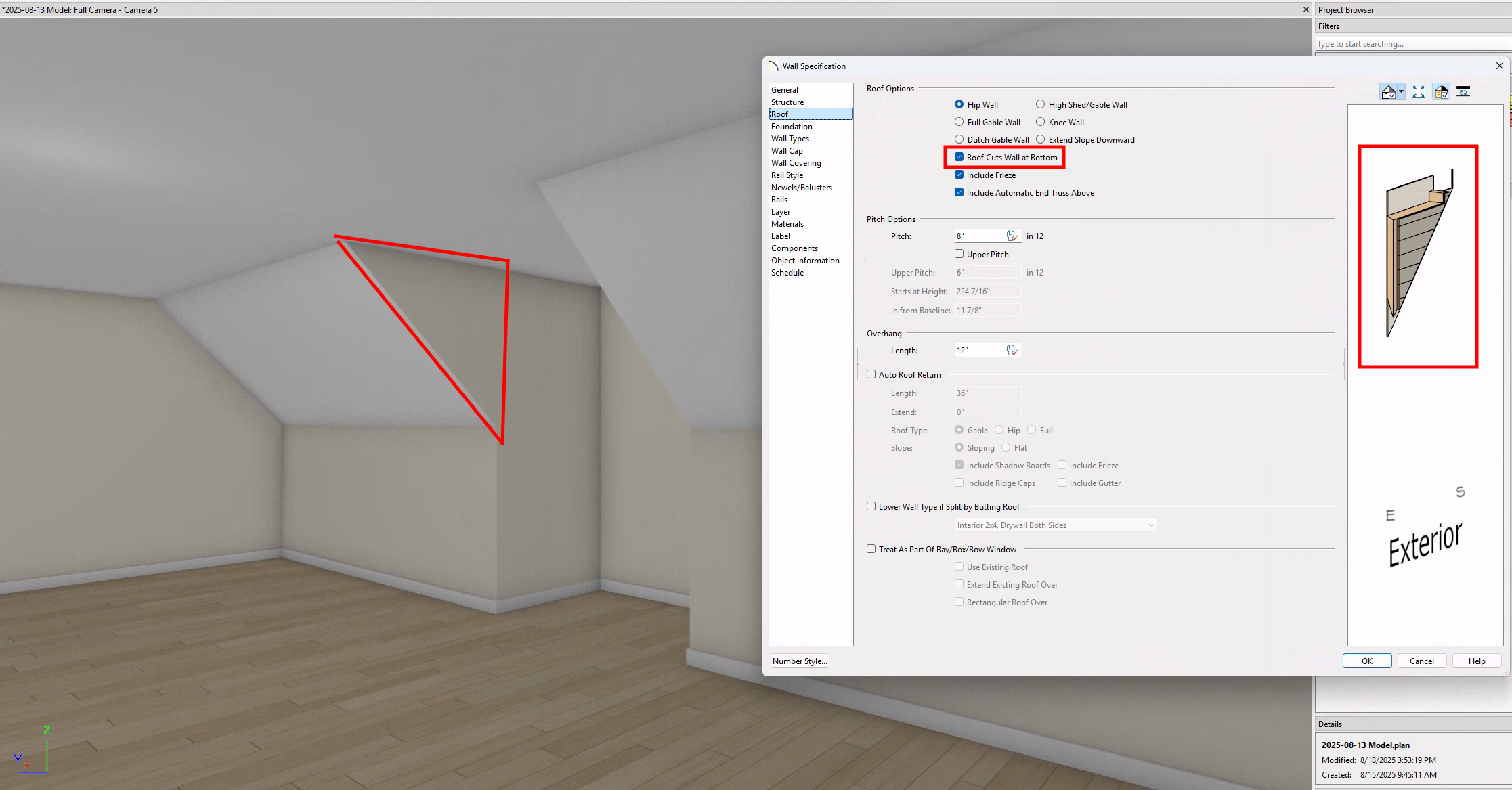

JLU_Design Posted Monday at 08:11 PM Share Posted Monday at 08:11 PM You need to add a wall there then set it to be cut by the roof at the bottom. You may want to set it to be an attic wall so it doesn't show on the floor plan. Link to comment Share on other sites More sharing options...
cliffy Posted Wednesday at 06:06 PM Author Share Posted Wednesday at 06:06 PM This worked. Thank you Link to comment Share on other sites More sharing options...
