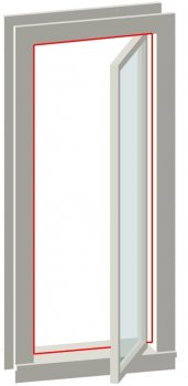

No1ZZTopfan Posted August 7, 2025 Share Posted August 7, 2025 I did a search but couldn't find an answer to this so if there is one, please direct me to it. With the casement door open, I would like to show a screen (indicated in red) here? I could just add an element with a screen material but I figured by now it would be an option in the settings since most windows of this type usually have a screen to keep out bugs and such. Thanks in advance. Link to comment Share on other sites More sharing options...

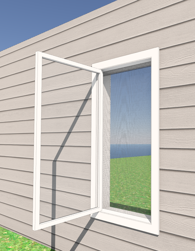

No1ZZTopfan Posted August 19, 2025 Author Share Posted August 19, 2025 (edited) Robert, Treatments can only be placed in the inside. Unless you found a way to put them on the outside. What I have done is take a wall cabinet fixture, changed the settings to make it appear like a screen, matching the size of the window's exterior. Used glass as the material on the front panel and screen material on the door panel. Edited August 19, 2025 by No1ZZTopfan Link to comment Share on other sites More sharing options...

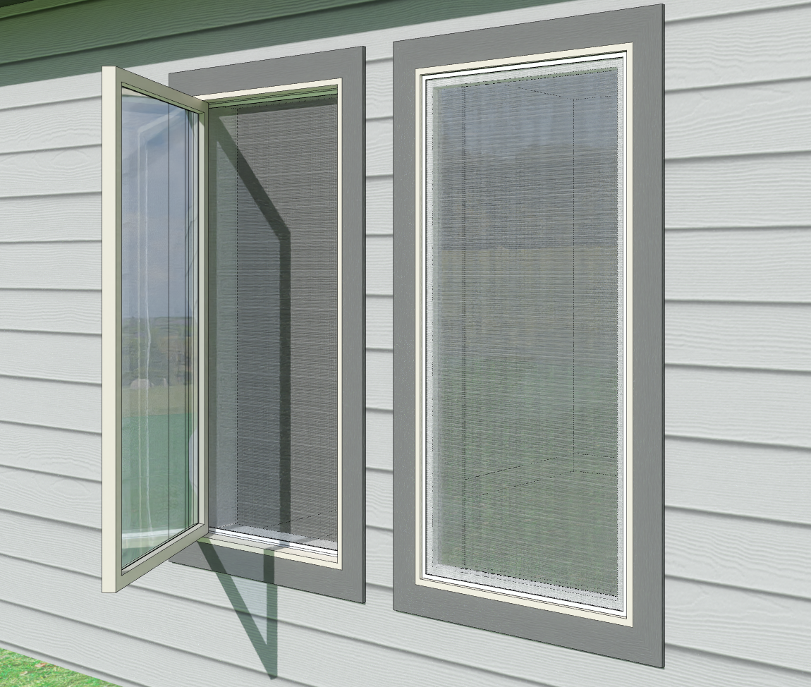

robdyck Posted August 20, 2025 Share Posted August 20, 2025 So you'd like an exterior mounted screen for a casement window? The casement window opens to the interior? That can be done! You'll just need to set a y-axis offset for your exterior mounted screen. Start with something like 3" then examine in section view and adjust the symbol. Then open the window and replace the 'blind'. 1 Link to comment Share on other sites More sharing options...
