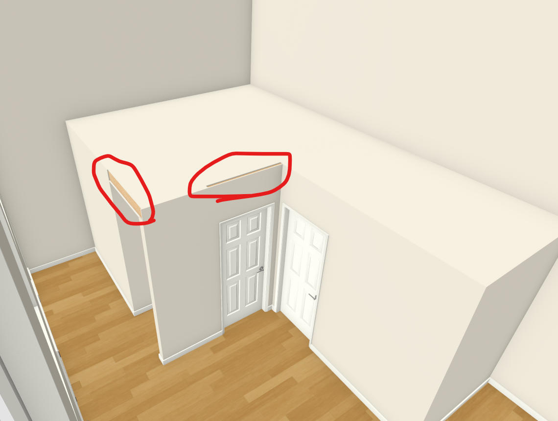

builtright3 Posted July 29, 2025 Share Posted July 29, 2025 I made a shelf ceiling and I cant figure out why the drywall did not show up in these locations. Can anyone help me please? Plan file attached:Shelf Ceiling.zip Link to comment Share on other sites More sharing options...
Solution Renerabbitt Posted July 29, 2025 Solution Share Posted July 29, 2025 13 minutes ago, builtright3 said: I made a shelf ceiling and I cant figure out why the drywall did not show up in these locations. Can anyone help me please? Plan file attached:Shelf Ceiling.zip see video: 250729 (9).mp4 1 Link to comment Share on other sites More sharing options...
builtright3 Posted July 29, 2025 Author Share Posted July 29, 2025 Thank you Rene! Link to comment Share on other sites More sharing options...
