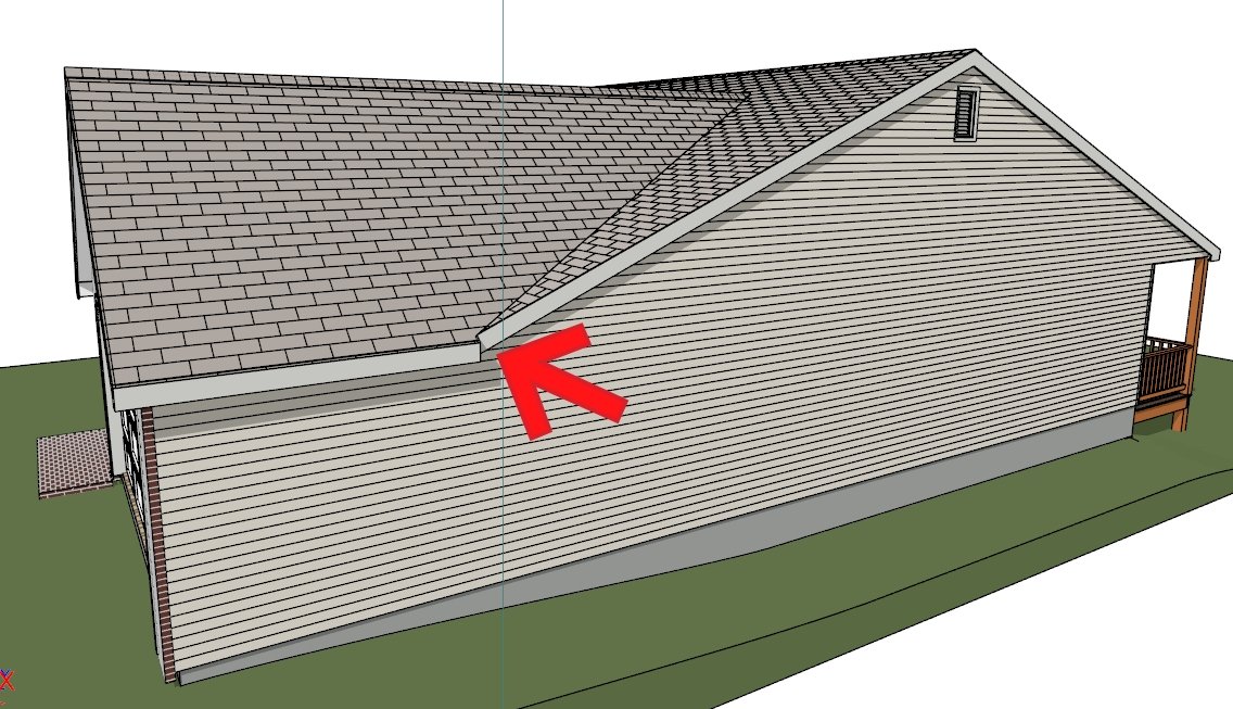

MtGipe Posted July 28, 2025 Share Posted July 28, 2025 Is there a way to achieve the reduced gable overhang as shown in the actual photo...with auto-roof settings on? Marshall X16 Link to comment Share on other sites More sharing options...

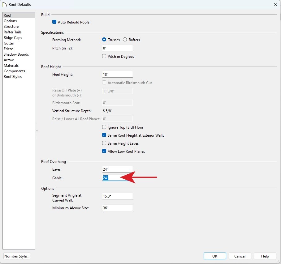

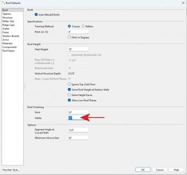

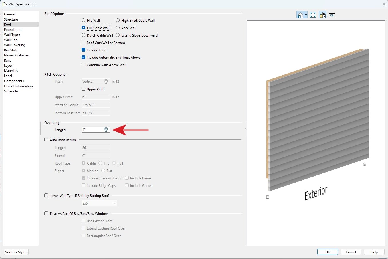

rlackore Posted July 28, 2025 Share Posted July 28, 2025 Default Settings>Roof>Roof Overhang>Gable Set the value to what you need, taking into account the thickness of the exterior wall finish. Link to comment Share on other sites More sharing options...

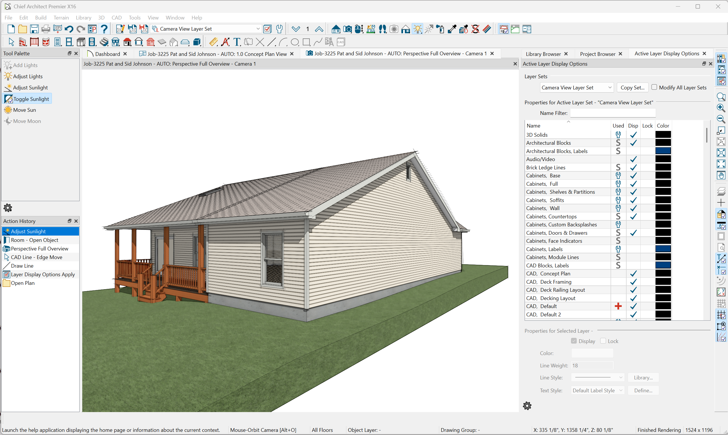

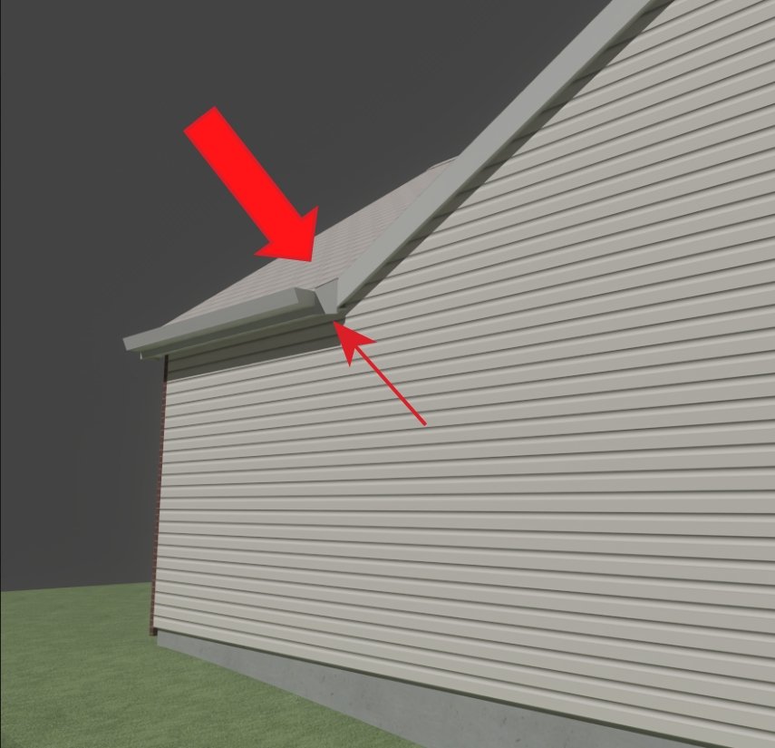

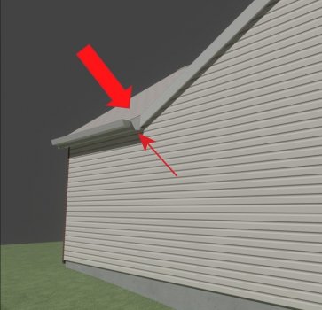

MtGipe Posted July 28, 2025 Author Share Posted July 28, 2025 Yeah...I went that direction initially, but the gable overhang will not reduce. The house end wall is broken to achieve the front gable portion (in the distance). It seems that the wall break will not allow the gable wall to reduce the overhang with auto settings for some reason. Link to comment Share on other sites More sharing options...
rlackore Posted July 28, 2025 Share Posted July 28, 2025 Then select the wall that you want to reduce the overhang, and: Wall Specification>Roof>Overhang>Length Link to comment Share on other sites More sharing options...
MtGipe Posted July 28, 2025 Author Share Posted July 28, 2025 Here's the .plan file. (my apologies for not sharing this initially). I've tried all the normal auto-roof work-arounds (and default or specific wall settings, as well as roof gable lines) that I know but can't seem to make this simple roof type render correct For context: I do conceptual design with the builder/client looking over my shoulder vie Zoom and as such, I fight really hard to keep auto-roof settings on (as well as auto deck framing, etc...). Some projects we advise the client to overlook small rendering discrepancies to allow us to chow them options quickly via auto-settings being on. This may be case for this one as well, but it looked so simple to me that I was sure there'd be a quick way to direct the software to reduce the gable overhang and box the eave overhang.... Job-3225 Pat and Sid Johnson - AUTO.zip Link to comment Share on other sites More sharing options...
rlackore Posted July 28, 2025 Share Posted July 28, 2025 I don't think you can get what you want with auto-build turned on because Chief's logic can't resolve the intersection with the garage eave. Link to comment Share on other sites More sharing options...

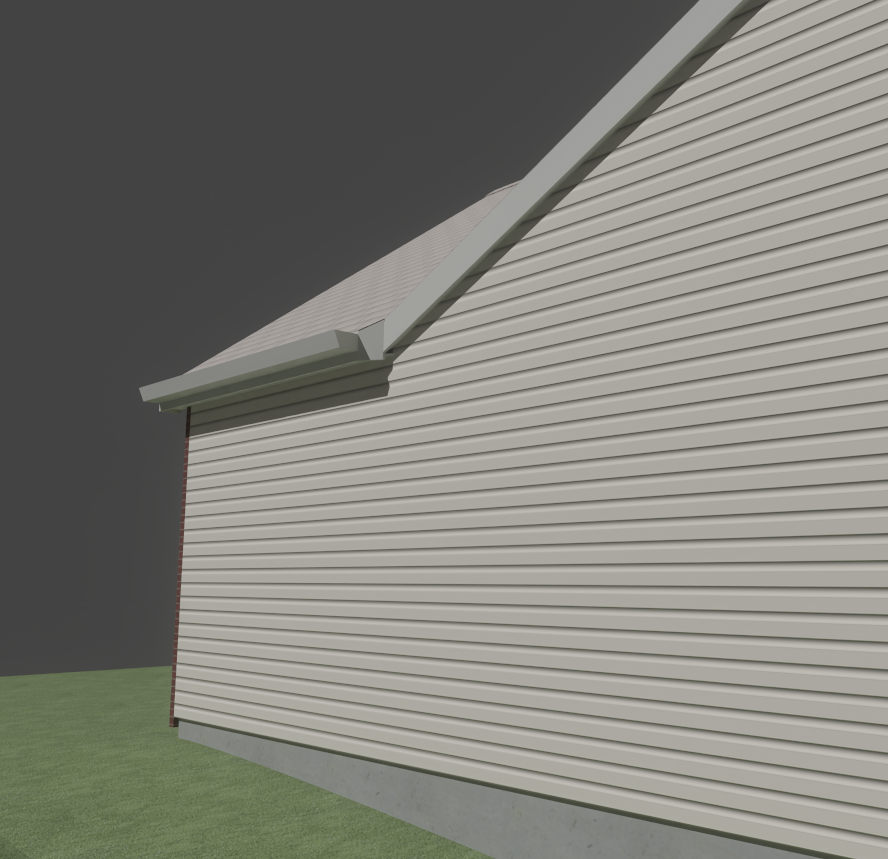

Renerabbitt Posted July 28, 2025 Share Posted July 28, 2025 31 minutes ago, rlackore said: I don't think you can get what you want with auto-build turned on because Chief's logic can't resolve the intersection with the garage eave. it can. Use baseline polylines 1 Link to comment Share on other sites More sharing options...
rlackore Posted July 28, 2025 Share Posted July 28, 2025 Renerabbit, can you accomplish that while keeping the 12" eave overhang at the intersecting roof plane? Link to comment Share on other sites More sharing options...
Renerabbitt Posted July 28, 2025 Share Posted July 28, 2025 5 minutes ago, rlackore said: Renerabbit, can you accomplish that while keeping the 12" eave overhang at the intersecting roof plane? is that something other than what I am showing in this screenshot? Link to comment Share on other sites More sharing options...
rlackore Posted July 28, 2025 Share Posted July 28, 2025 20 minutes ago, Renerabbitt said: is that something other than what I am showing in this screenshot? I guess it must be my eyes playing tricks, it's just very difficult to tell from the angle. My apologies. Link to comment Share on other sites More sharing options...
MtGipe Posted July 29, 2025 Author Share Posted July 29, 2025 @RenerabbittWow! This opens up a whole new world (a bit). I've played a round...and as soon as a I pull the baseline in for the reduced overhang I lose my 5:12 front to back gable (see the attached). Am I missing something simple? (probably) And if it's easier to point me to a more in depth video or resource, that works well too. Thanks for your help! (I read an article from Chief on them to get me this far) Job-3225 Pat and Sid Johnson - AUTO.zip Link to comment Share on other sites More sharing options...
