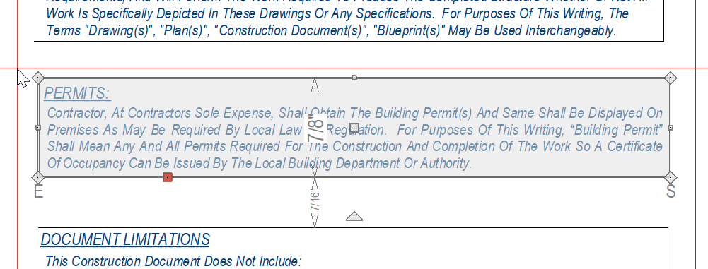

Ed_Orum Posted July 24, 2025 Share Posted July 24, 2025 Whenever I send a CAD detail to the layout sheet from the plan file, a border box surrounds the actual CAD detail. This makes lining up the CAD boxes a time consuming chore, since the border box does not appear on all CAD details. I have attached a screenshot. Am I doing something wrong when I export the CAD details, or is there a setting somewhere I need to look at? Unfortunately the resolution of the screen shot is not that great, but if you look at the partial box above, and the one below, those CAD details show the single border. The one that says "Permits" has the double box. Thanks in advance Lane Link to comment Share on other sites More sharing options...
PitMan71 Posted July 24, 2025 Share Posted July 24, 2025 I wonder if there is a border around the text and a border for the layout box and both are on for some reason in that layout view. Link to comment Share on other sites More sharing options...

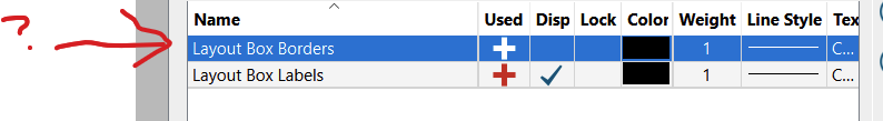

JKEdmo Posted July 24, 2025 Share Posted July 24, 2025 55 minutes ago, Ed_Orum said: Whenever I send a CAD detail to the layout sheet from the plan file, a border box surrounds the actual CAD detail. This makes lining up the CAD boxes a time consuming chore, since the border box does not appear on all CAD details. I have attached a screenshot. Am I doing something wrong when I export the CAD details, or is there a setting somewhere I need to look at? Unfortunately the resolution of the screen shot is not that great, but if you look at the partial box above, and the one below, those CAD details show the single border. The one that says "Permits" has the double box. Thanks in advance Lane Lane, Is it this? 1 Link to comment Share on other sites More sharing options...
