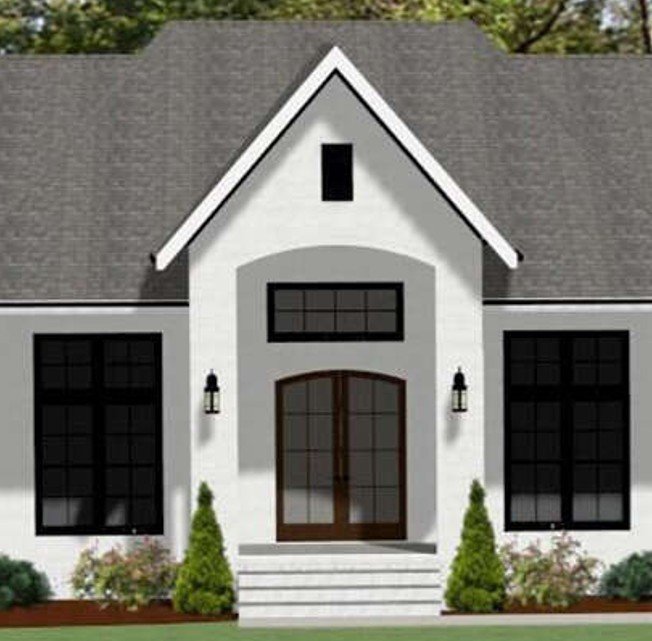

WayneG Posted July 16 Share Posted July 16 Hi, I have tried many times to get a porch with high walls, and have failed every time. How is this done?? I have an example picture attached. Link to comment Share on other sites More sharing options...
glennw Posted July 16 Share Posted July 16 Give the Porch room a larger ceiling height. Are you doing auto roofs? Do the above and if you are using auto roofs you may get crickets or other screwy things where the roofs meet. If you get that far, post back here for the solution to that problem. Link to comment Share on other sites More sharing options...

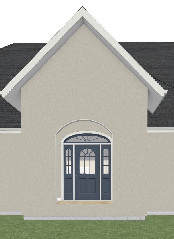

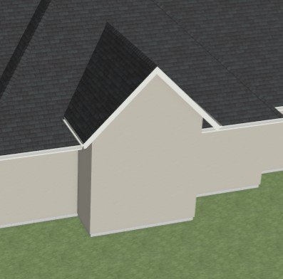

WayneG Posted July 16 Author Share Posted July 16 Hi, finally I figured it out, instead of using a porch, I used an Entry room and raised the ceiling. I had to play around with the roof planes a bit, but there it is. 2 Link to comment Share on other sites More sharing options...
Abdulhadi22 Posted August 6 Share Posted August 6 On 7/16/2025 at 5:04 AM, WayneG said: Hi, I have tried many times to get a porch with high walls, and have failed every time. How is this done?? I have an example picture attached. Hi! To get high porch walls like your example, build the porch with full-height standard walls instead of railings, then set the front wall to have a gable using the “Roof Directly Over This Wall” or the “Gable/Roof Line” tool. This lets you control wall height and roof shape precisely. If you want to visualize and compare different wall heights, you can try Height Comparison Chart. Link to comment Share on other sites More sharing options...
WayneG Posted August 7 Author Share Posted August 7 Great, Thank You for your post it was right on time 1 Link to comment Share on other sites More sharing options...
