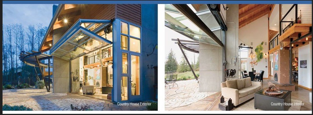

capitaldesigns Posted April 30 Share Posted April 30 I am working on plans for a custom home. The client wants to use two residential hanger style glass doors. See attached picture. Does anyone know how I show this type of door in CA ? Thanks, Mike Link to comment Share on other sites More sharing options...
Designers_Ink Posted April 30 Share Posted April 30 I just did an 8' wide X 8' tall doorway, then created this symbol with 3D solids to insert in the opening. You can explode it and adjust as needed. Hope that helps. 8' Vertical Bi-fold Door.calibz 1 1 Link to comment Share on other sites More sharing options...
capitaldesigns Posted April 30 Author Share Posted April 30 Thank You for creating the door. Mike Link to comment Share on other sites More sharing options...
