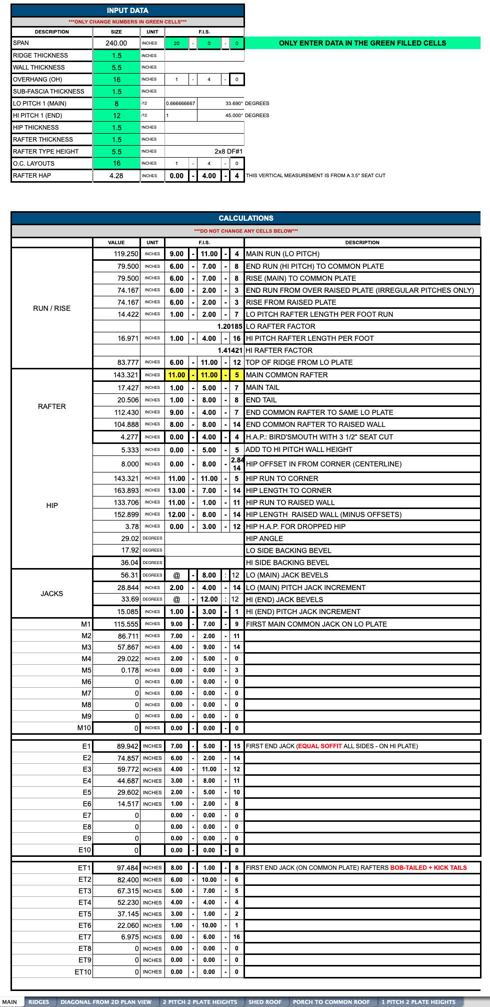

para-CAD Posted 3 hours ago Author Share Posted 3 hours ago Some day I'll set this one free....... Link to comment Share on other sites More sharing options...
