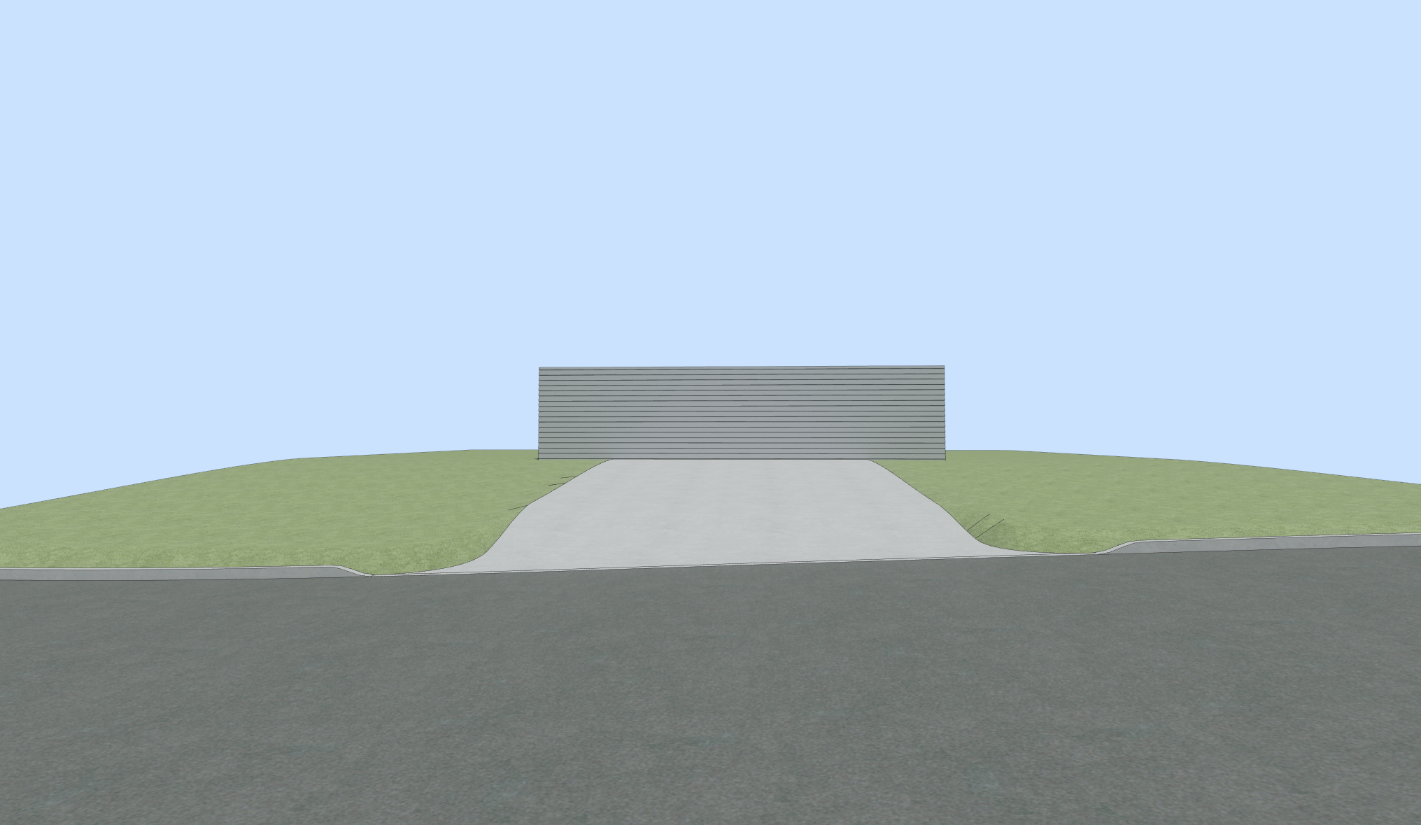

LeeDrafter Posted October 20 Share Posted October 20 Hello, I am working on some home designs on lots along a street that is sloped. So, the driveways will be sloped side-to-side as they connect with the street. The driveway tool allows slope to follow the terrain from front to back of the driveway, but as far as I can tell, it does not allow slope from side to side. At the house, it obviously has to be flat as it connects to the level garage, but the street is not level, so it will have to have slope in multiple directions. How can I acheive this? And thank you for any help. Link to comment Share on other sites More sharing options...
Solution JonathanK Posted October 20 Solution Share Posted October 20 (edited) It's all about setting your terrain elevation data correctly. It should build the driveway sloped with the terrain with just the regular driveway tool, but you can use the polygon driveway tool as well. The only problem is that it doesn't cut your curb like the regular one does. Either way, Chief's terrain tools are ok at best, but you should still be able to get kind of close. You might have weird artifacts pop up, though. Edited October 20 by JonathanK 1 Link to comment Share on other sites More sharing options...
LeeDrafter Posted October 20 Author Share Posted October 20 2 hours ago, JonathanK said: It's all about setting your terrain elevation data correctly. It should build the driveway sloped with the terrain with just the regular driveway tool, but you can use the polygon driveway tool as well. The only problem is that it doesn't cut your curb like the regular one does. Either way, Chief's terrain tools are ok at best, but you should still be able to get kind of close. You might have weird artifacts pop up, though. Thank you Jonathan, the problem was that I didn't have a road drawn. Once I drew the road and made the intersection connect the driveway to the road, it fixed itself and follows the terrain. thank you! Link to comment Share on other sites More sharing options...
