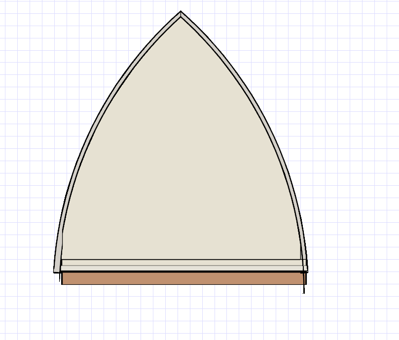

I quickly made this using the roofs / curved roof option in the DBX.
You'll have to find tune it etc, but i just set the main floor walls to 12' and the roof to 24/12 and turned on the curved roof tool.
She's quick n' dirty but with some tinkering im sure you could get it to work for you.
