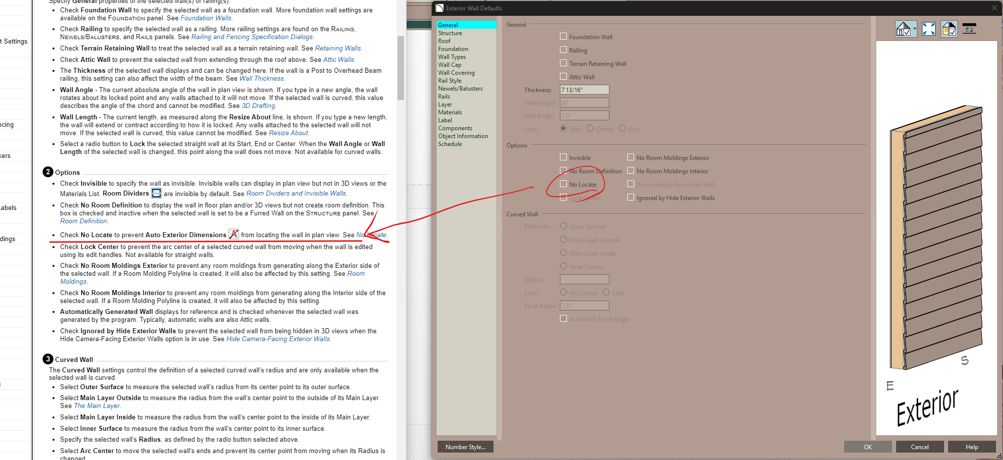

GLOBE-Res Posted August 19 Share Posted August 19 I don't want Automatic dimensions to dimension interior walls that touch the exterior walls. I can't seem to turn that off. Any suggestions? Link to comment Share on other sites More sharing options...
Renerabbitt Posted August 19 Share Posted August 19 7 minutes ago, GLOBE-Res said: I don't want Automatic dimensions to dimension interior walls that touch the exterior walls. I can't seem to turn that off. Any suggestions? Link to comment Share on other sites More sharing options...
