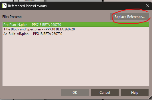

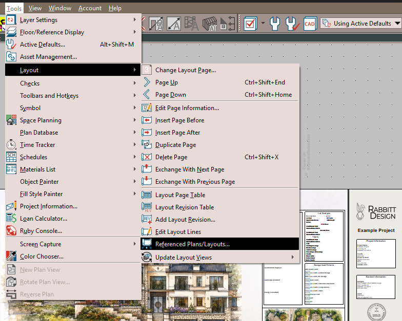

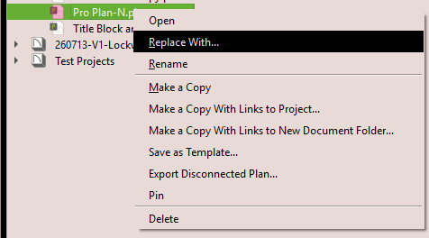

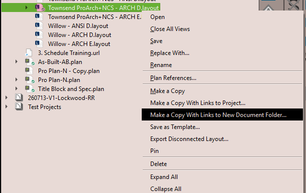

Solution Renerabbitt Posted July 21 Solution Share Posted July 21 (edited) 2 hours ago, SureFoot said: There must be a more efficient way to create a sandbox environment where I can play with my plan without being fully commited to it, Make a copy to play with Right click your linked plan and choose "Replace With" and target your copied plan OR Make a copy to play with Open layout and goto Tools/Layout/Referenced Plan files and replace the other plan file with your copy plan file in the subsequent dialogue box OR Right click your Layout and choose Make a copy with links to a new folder, and that is a completely contained copy of your layout with its linked plans that are not linked to the originals Edited July 21 by Renerabbitt 1 Link to comment Share on other sites More sharing options...
