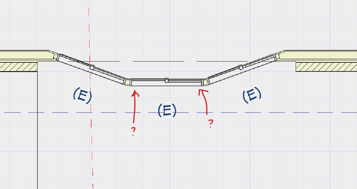

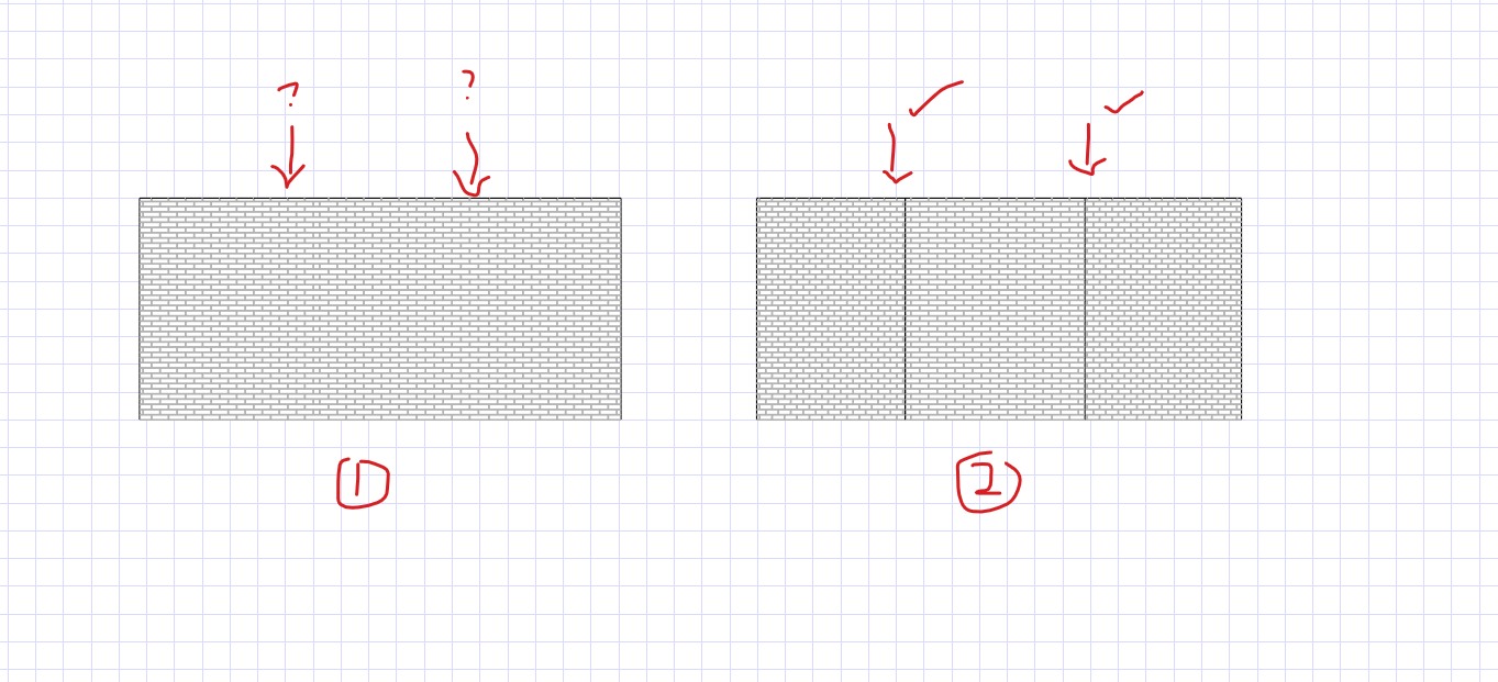

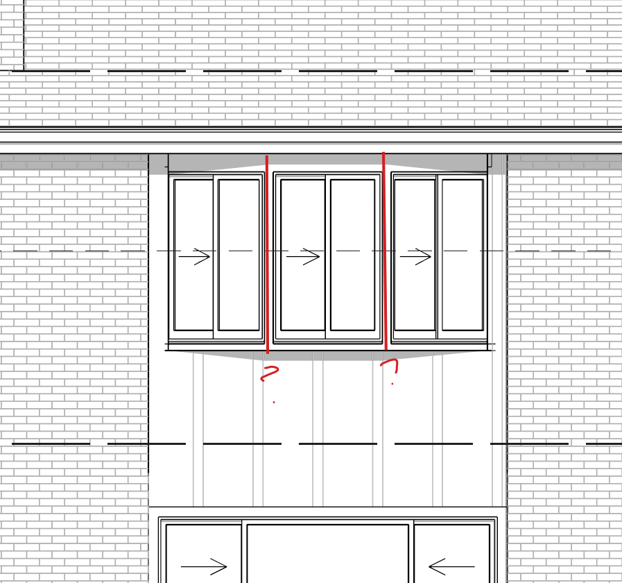

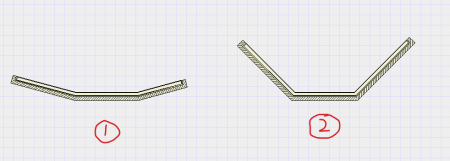

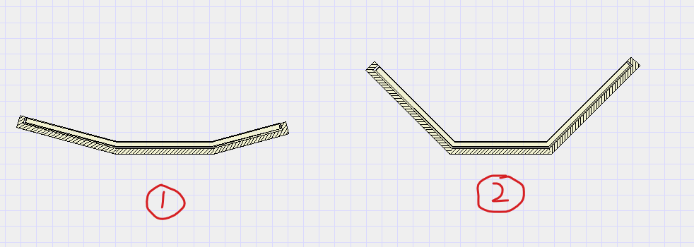

JKEdmo Posted July 16 Share Posted July 16 I noticed the outside corner lines of my bay window are not generating in vector view... Plan: Vector view elevation: As a test, I wondered what the result would be with exterior walls. Same result... Shallow angles (1) do not generate the elevation line, but 45 degree walls angles (2) do: Anybody know why? Is this a bug or is there a setting that controls this? Thanks again, Jim Link to comment Share on other sites More sharing options...
DianneDSC Posted July 17 Share Posted July 17 I just noticed this yesterday. No line in elevation for a shallow angle wall. Using X17. Link to comment Share on other sites More sharing options...
JKEdmo Posted July 17 Author Share Posted July 17 56 minutes ago, DianneDSC said: I just noticed this yesterday. No line in elevation for a shallow angle wall. Using X17. Thanks for confirming Dianne. I may send in as bug report. I'll see if others chime in too. Link to comment Share on other sites More sharing options...
DianneDSC Posted July 17 Share Posted July 17 I'll send in a report as well. Link to comment Share on other sites More sharing options...
JKEdmo Posted July 17 Author Share Posted July 17 I sent in to support for their review. I'll reply back when they answer. - Jim Link to comment Share on other sites More sharing options...

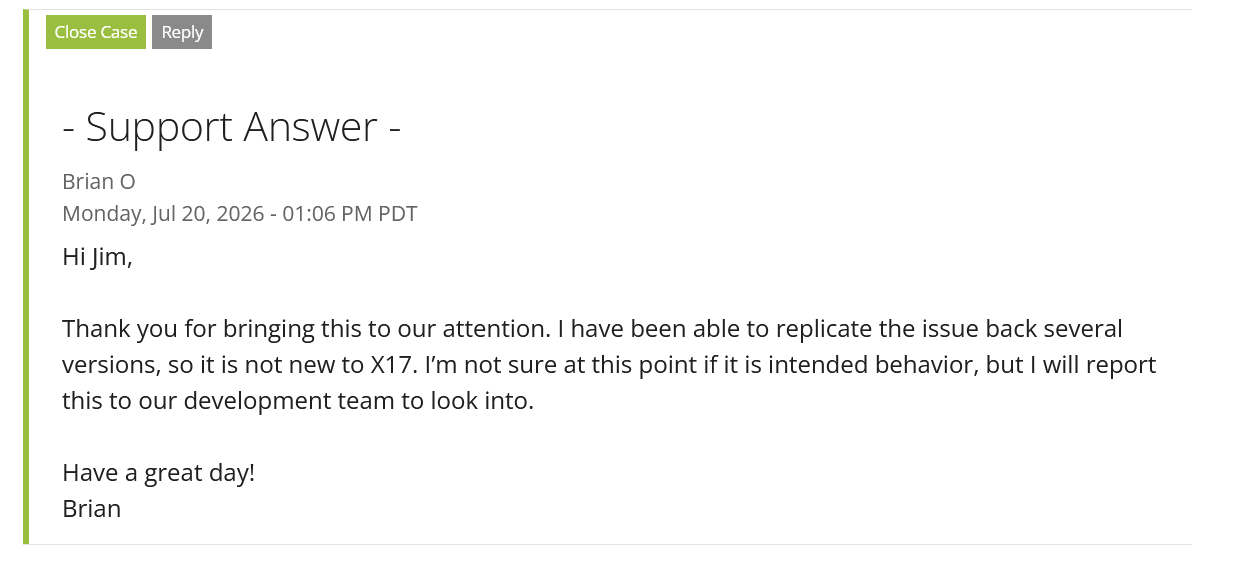

JKEdmo Posted Monday at 08:10 PM Author Share Posted Monday at 08:10 PM To follow up, I got a reply back from Chief about this issue. They were able to re-create it and are going to look into it. Jim Link to comment Share on other sites More sharing options...
