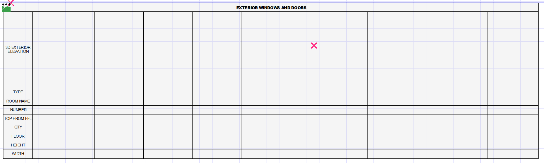

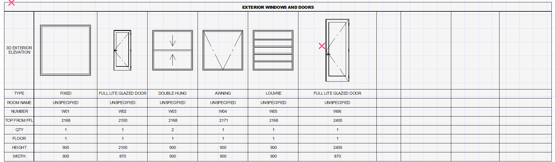

Frenchy1 Posted Thursday at 07:24 AM Share Posted Thursday at 07:24 AM (edited) Hi all, I have a window schedule that lives on my layout that's live to my plan so it's automatically updated. This plan to layout is my standard template that I copy from job to job. It's a blank plan until I start to fill it out which in turn fills out the layout page which fills out the window schedule. I have this issue where it all works fine but it has empty columns at the end of the window schedule and I was wondering if anyone else could tell me what they are and how to get rid of them as it bugs me. I can squash them up to make it look less obvious but it still annoys me. The final image showing the empty window schedule is when I have removed all the windows and doors in my plan and it leaves empty void areas. Edited Thursday at 07:27 AM by Frenchy1 Link to comment Share on other sites More sharing options...

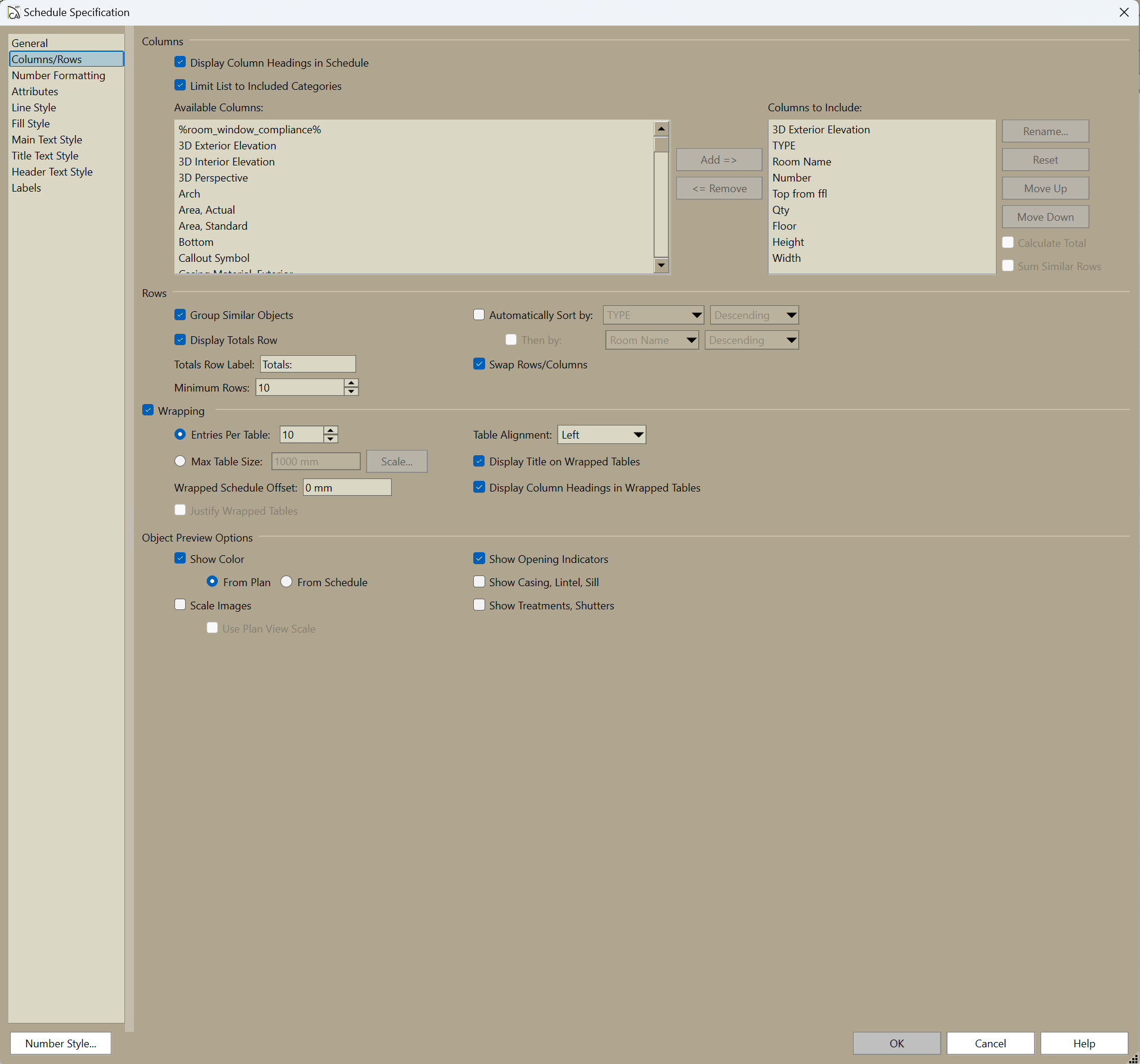

DBCooper Posted Thursday at 03:24 PM Share Posted Thursday at 03:24 PM I think I can tell what you did just from your pictures. You swapped your rows and columns and you set your minimum rows to 10. When swapped, it should probably say "minimum columns" instead of "minimum rows". 1 Link to comment Share on other sites More sharing options...
