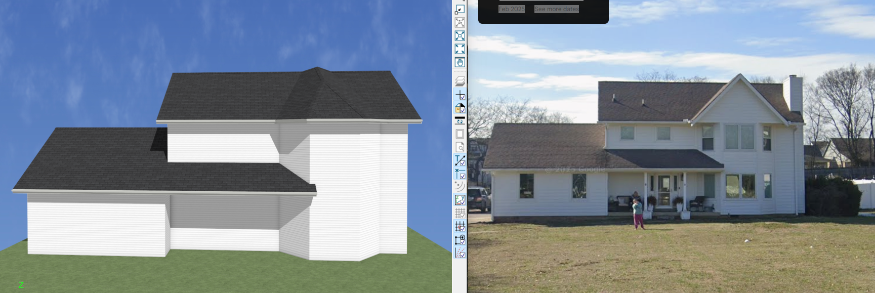

ARLLCDesign Posted June 30 Share Posted June 30 My thought is that this should be built as a dormer above it but it exceeds the bay on both sides and I'm just not positive what the best route is. Tramel, Chris & Angie (ash as is).plan Link to comment Share on other sites More sharing options...

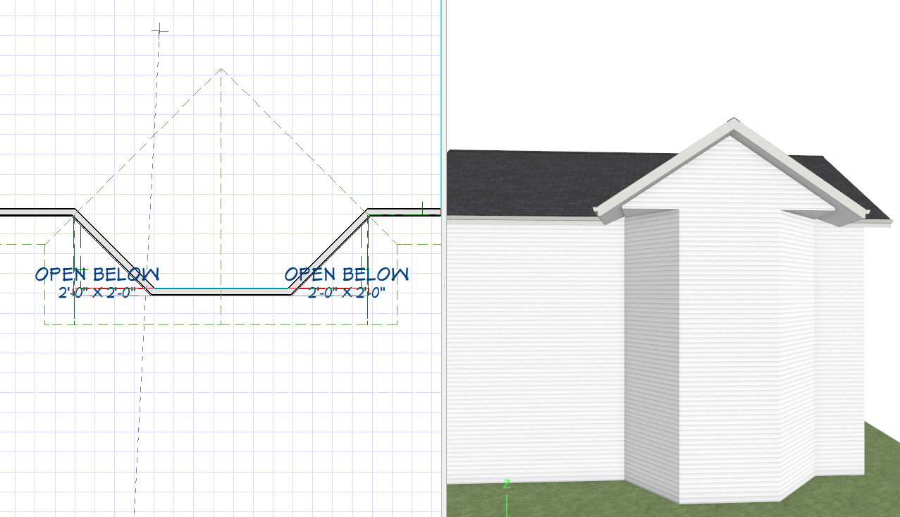

CarrieS Posted July 16 Share Posted July 16 You could draw the roof planes manually or if you wanted to use Auto Rebuild Roofs then you could create small "open below" rooms so you could get the roof controls. Link to comment Share on other sites More sharing options...
