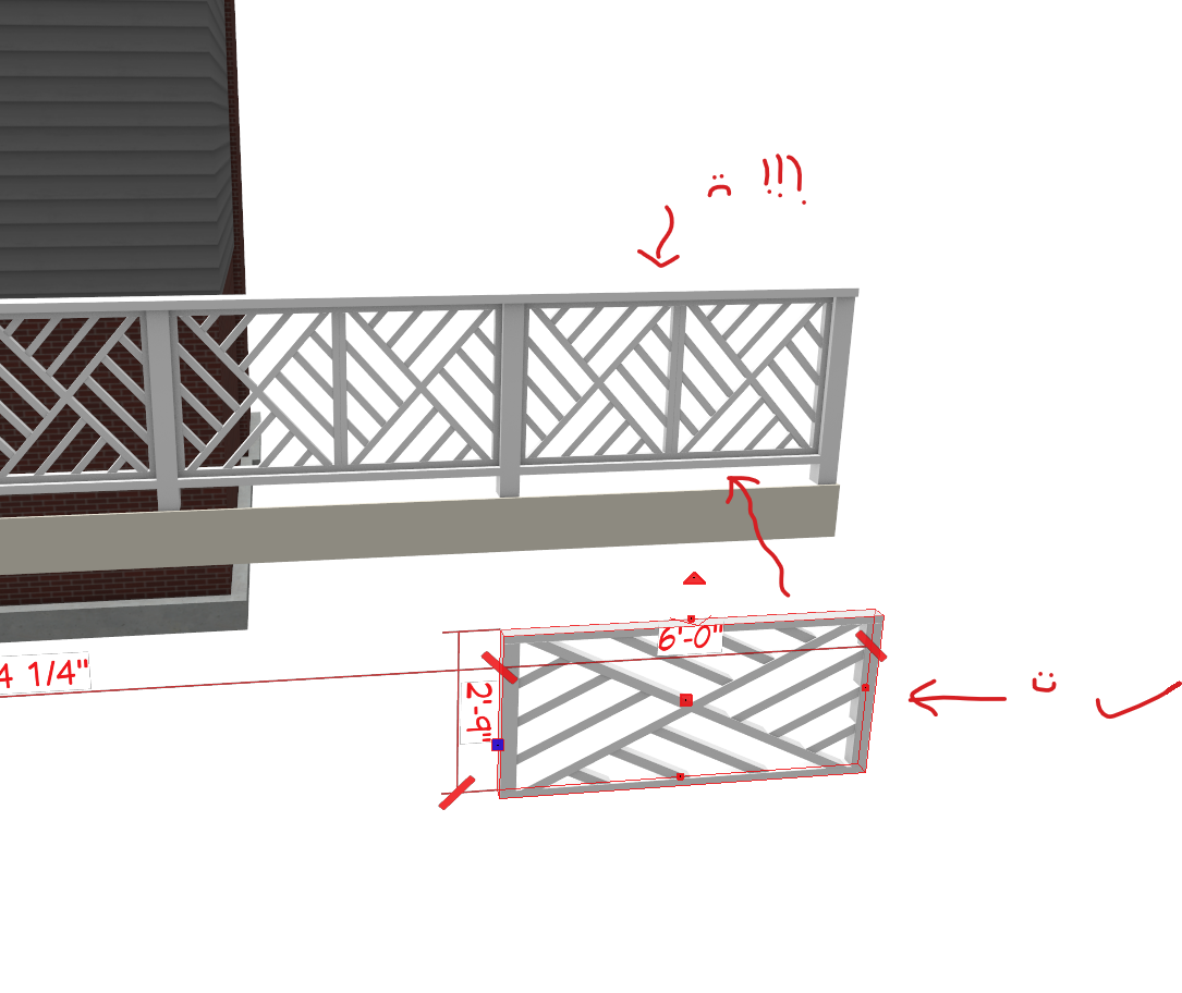

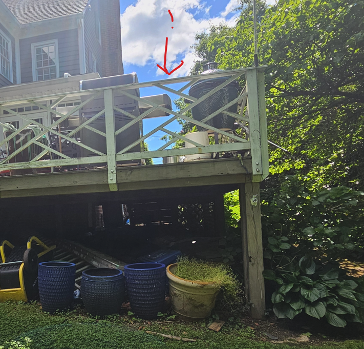

I have a deck railing with posts spaced 6 feet on center.

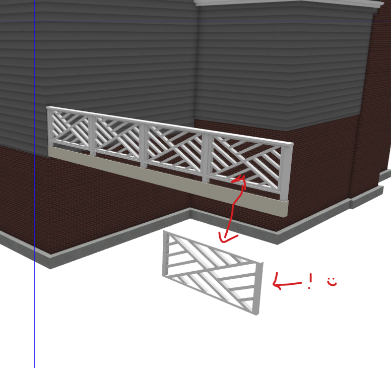

I have a Chippendale railing infill panel about 72" x 33" in size.
I'd like one panel per post spacing (stretched), but for some reason the Chief makes the panel infill square in size with 2 per post spacing...
Any tips to correct this would be appreciated.
Thanks again,
Jim

Thanks Shane for looking into this.  It did not have a stretch plane.  But, I figured it out.  I had based the panel on an original Chief "diamond rail panel," which I just resized to make wider.  However, the original Chief square shape carried through even though I had resized it (?).  The fix was I (re-)converted the panel to a millwork symbol and that worked.
Jim
