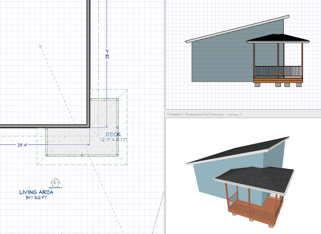

JRANGUETTE Posted May 1 Share Posted May 1 Trying to build a roof over a deck attached to a shed roof building. Not sure what I'm missing!! It keeps doing this when I add roof over this room (deck) ROOF ISSUE.pdf Link to comment Share on other sites More sharing options...

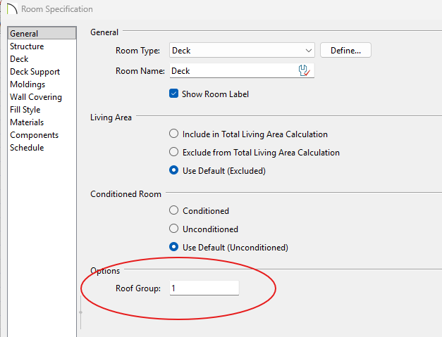

CarrieS Posted May 1 Share Posted May 1 Hi, This is one of those rare scenarios where you want to use the "Roof Group" setting. Select the Deck room and on the General panel set the "Roof Group" to 1. This will tell Chief to have the two rooms to not consider each other when drawing the roof. Link to comment Share on other sites More sharing options...
