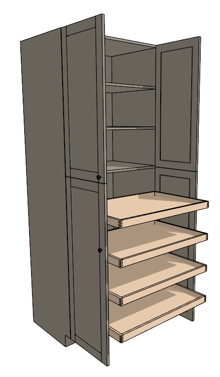

SC_drafting Posted April 22 Share Posted April 22 (edited) Hey all, I'm trying to model this full height cabinet with pullouts in the bottom. I can make the pullouts just fine in one half, but they'll only display on that side of the cabinet when I show it open, because the shelves are associated with each door in the front. How would I make the program understand that I want to make the shelving as if the two doors were one area without a separation in the middle? Edited April 22 by SC_drafting Link to comment Share on other sites More sharing options...

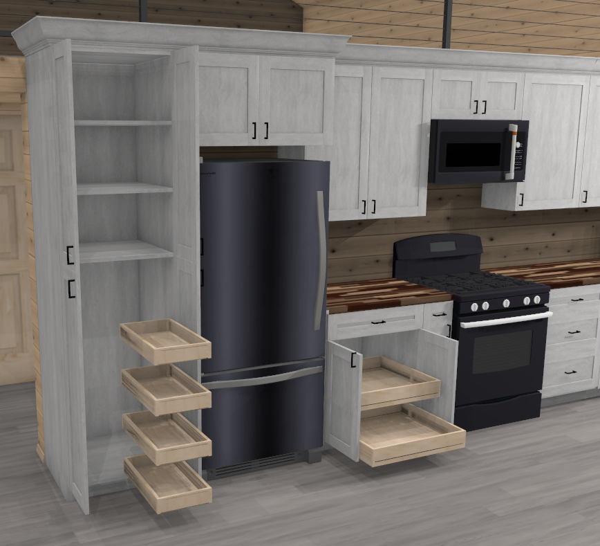

Solution CarrieS Posted April 22 Solution Share Posted April 22 Are you replacing the shelves with the rollout trays? If so then it seems you might be having two separate door components instead of 1 double door component. I've attached one that I have. Here is the article on the process too, in case you need it:https://www.chiefarchitect.com/support/article/KB-03142/replacing-a-cabinet-s-standard-shelves-with-rollout-shelves-or-drawers.html Cabinetwithpullouts.plan Link to comment Share on other sites More sharing options...
SC_drafting Posted April 22 Author Share Posted April 22 Yes, I replaced the door area with a double door and that solved the issue. Thank you! Link to comment Share on other sites More sharing options...
