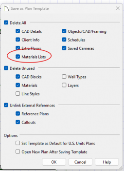

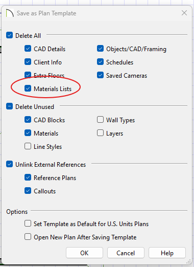

CarrieS Posted Wednesday at 07:50 PM Share Posted Wednesday at 07:50 PM If you have the Material List saved in the plan, you have the option to keep the Material List when you save the plan as a template (File> Templates> Save As Template). Just be sure to uncheck "Materials Lists" in the Save As Plan Template dialog. We do not currently have a way to move a saved Material List to a different project. Carrie 1 Link to comment Share on other sites More sharing options...
