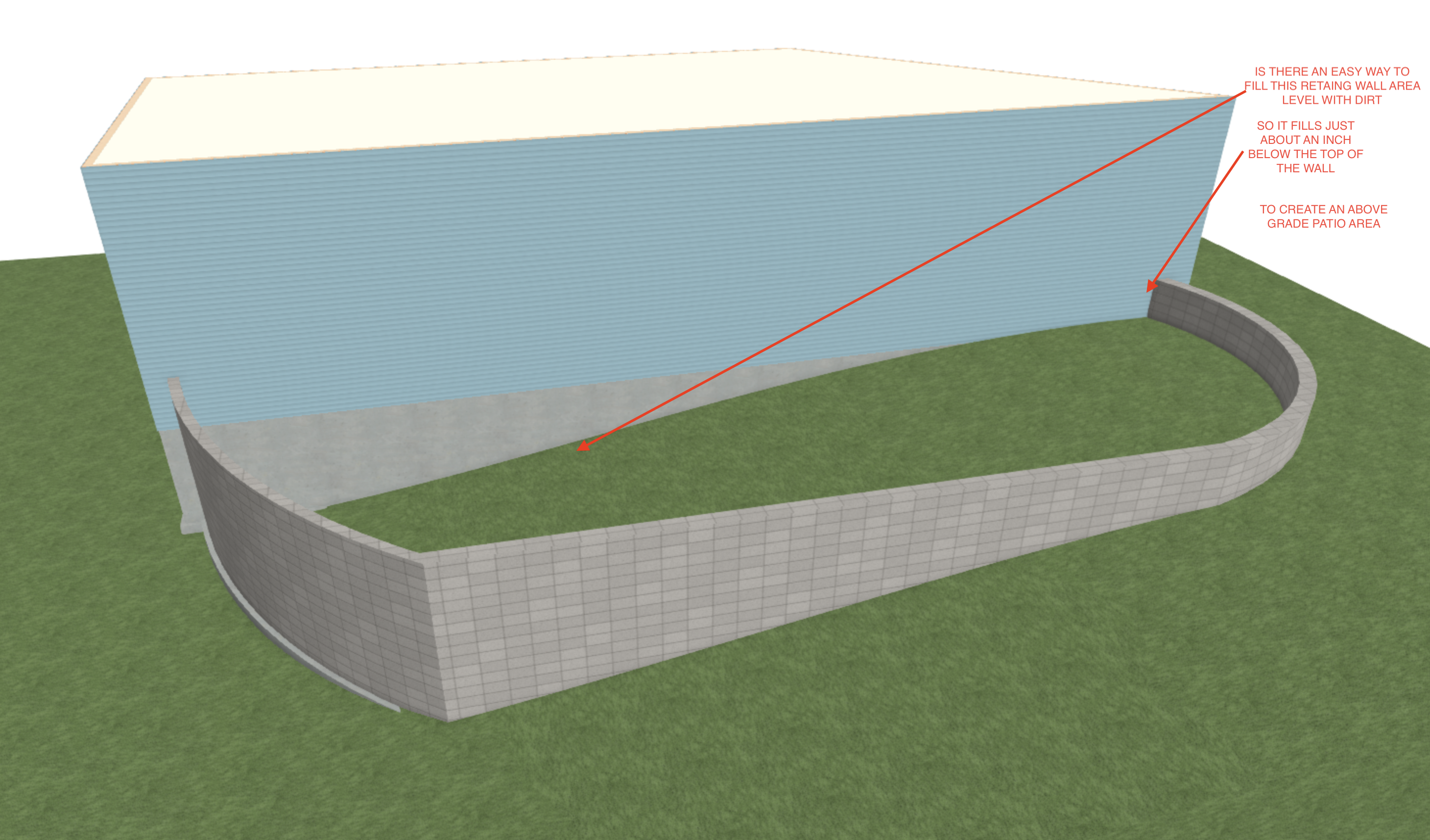

jjifmeyer Posted April 19 Share Posted April 19 Is there an easy way to fill a retaining wall area with a layer of Dirt and the a 3" top layer of gravel. Hope that makes sense. thanks. Jimmy Link to comment Share on other sites More sharing options...
tundra_dweller Posted April 19 Share Posted April 19 Here's what I would try to do. Create a polyline to match the inside perimeter of your retaining walls, then convert the polyline to an elevation region (I think this is possible?). Then copy/paste-hold position the elevation region and convert to a terrain feature or solid, change the materials of your new terrain feature/solid to your gravel. I think this should get you there as long as it is possible to convert polylines to elevation regions and convert elevation regions to polylines / terrain features / solids, which I can't remember if it is possible off the top of my head. Link to comment Share on other sites More sharing options...
