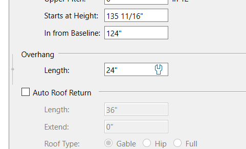

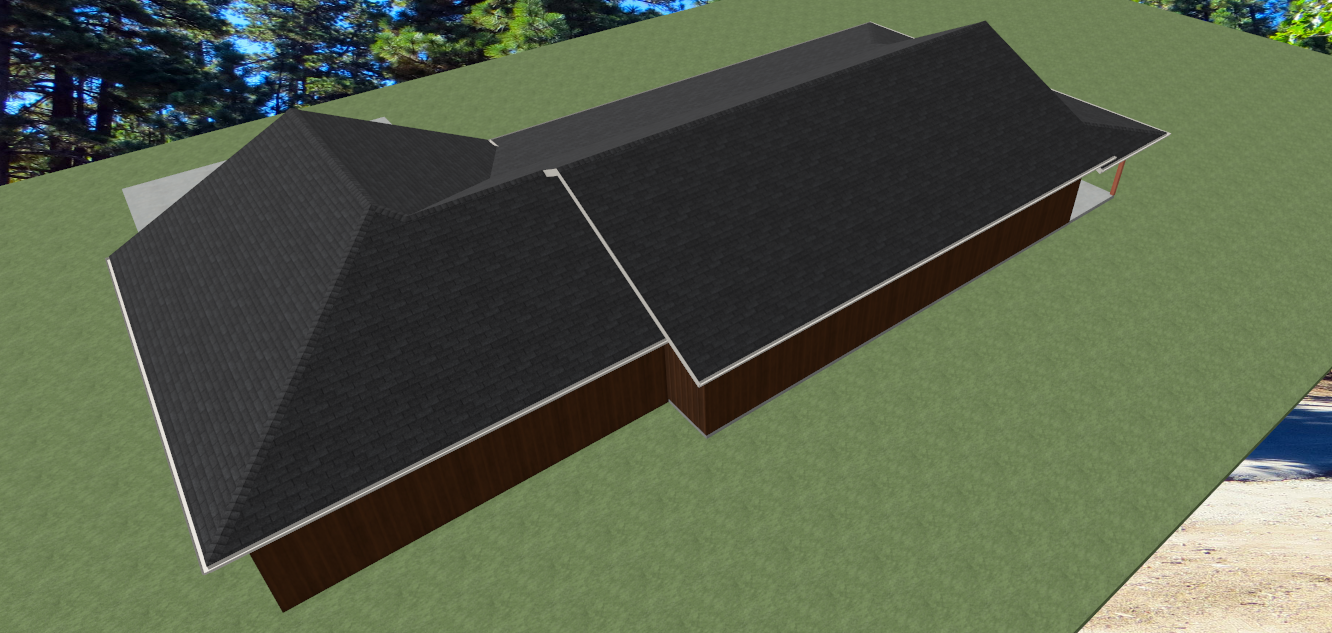

BakenUser Posted Sunday at 05:24 PM Share Posted Sunday at 05:24 PM I am working on this house plan with a wrap around porch. The main house has a 6/12 pitch and the porch has a 3/12 pitch. I have everything auto generating to this point. The problem is that for some reason it is using a 48" overhang on the porch when the default overhang is wet to 24". Am I missing a setting somewhere? Any ideas on what to change. I know that I can turn off auto generate and fix the issue but I want to keep on the auto generate roofs if possible. The other issue is on the back wall of the garage. With a hip roof it generates everything as it should but if I turn that wall into a gable it messes up the roof on the house. Any tips would be appreciated. Dave Link to comment Share on other sites More sharing options...
glennw Posted yesterday at 12:23 AM Share Posted yesterday at 12:23 AM The large eave overhang is a result of chief trying to maintain the same height eave as the rest of the house. Go to Build Roof>Roof Height Uncheck everything except Same Height Eaves, then rebuild the roofs. I think that is correct - just have a play with the various settings. Link to comment Share on other sites More sharing options...
