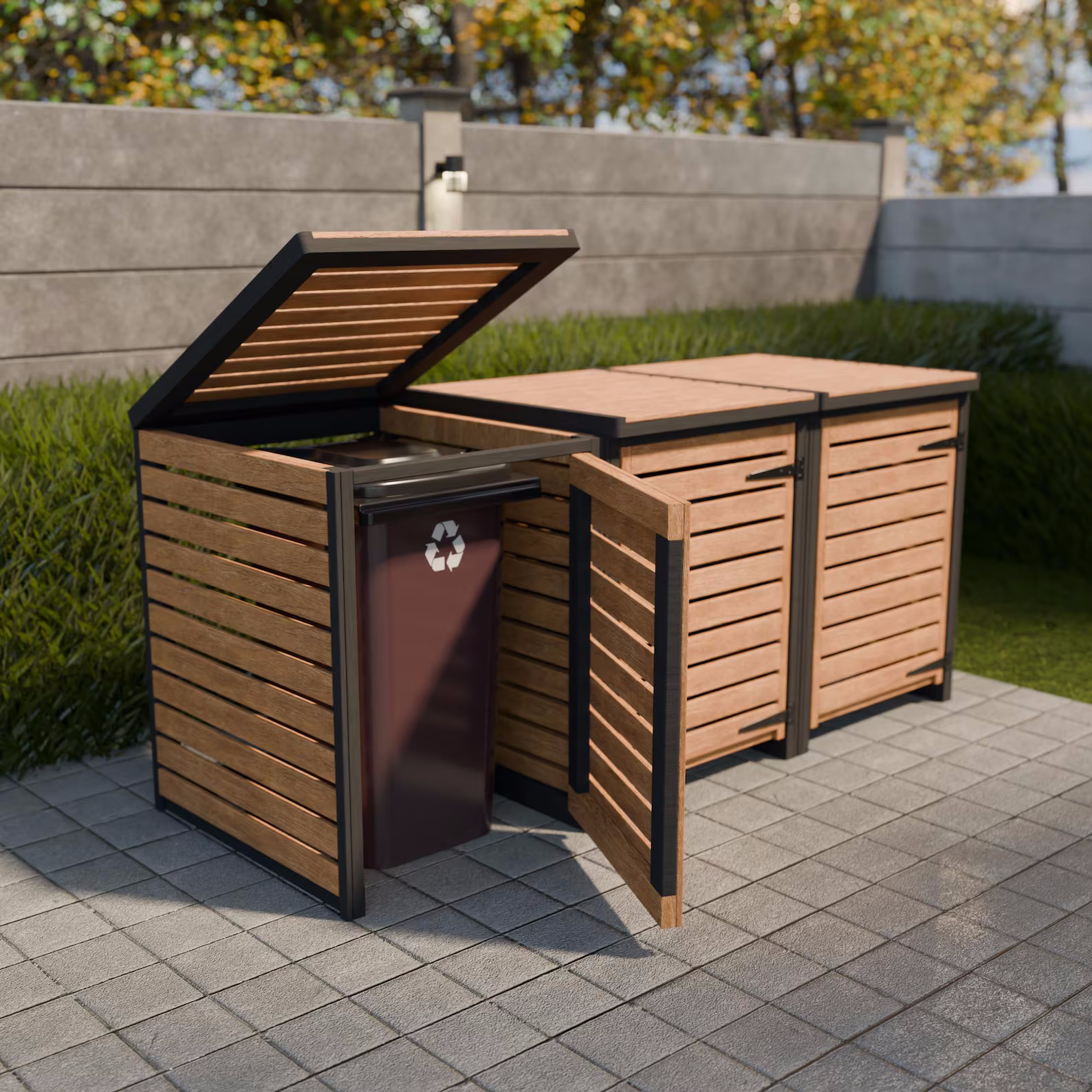

coastdesign Posted April 12 Share Posted April 12 Good morning, everybody. Happy Sunday! I am trying to figure out the best way to create this trash enclosure in CA 16. Anybody have some suggestions for me? Here are the dimensions that I am going to use: 7’-6” WIDE (2’-6” X 3) 3’ DEEP 6’ HIGH Thanks! Chris Link to comment Share on other sites More sharing options...
ACADuser Posted April 12 Share Posted April 12 Use solids, create a side & top panel. Copy & paste the sides, rotate into place & make into a single object, then copy 2 times. Make the frame a different material at the start. Link to comment Share on other sites More sharing options...
coastdesign Posted April 12 Author Share Posted April 12 Thank you for the suggestion. It sounds pretty easy but I think that is going to take some time, gonna have to figure that out. ...it is a start in the right direction, that's for sure! Do you know of the link to a specific link to creating the panels and then turning it into a box? How do you make the frame a different material? Link to comment Share on other sites More sharing options...
