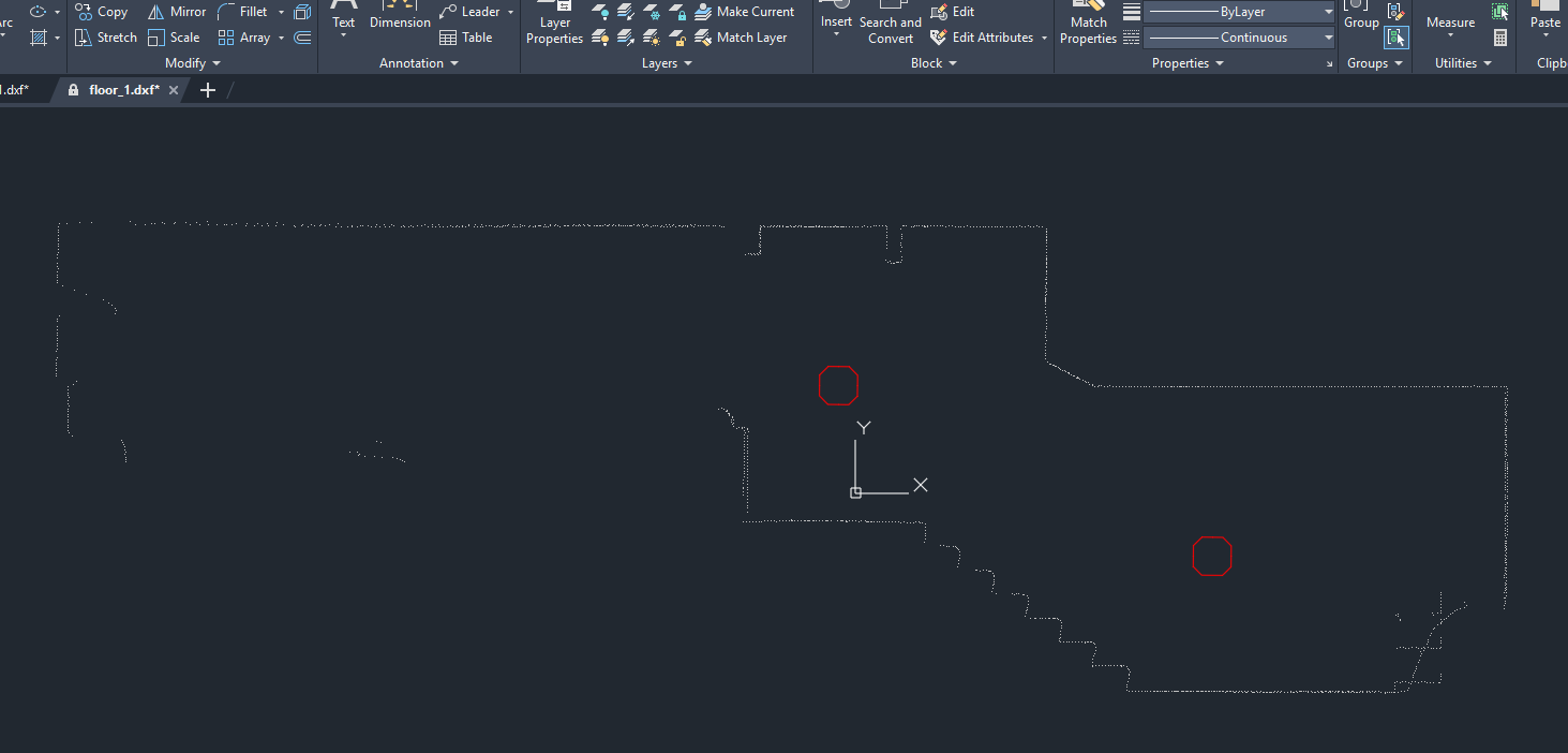

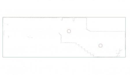

brookesdesign Posted April 6 Share Posted April 6 (edited) I've been using the iGuide Planix R1 lidar to scan floor plans. For a very low fee I can get the lidar scans as a DXF file. If I open them in Autocad I can see the data but when I import the DXF (or dwg) into Chief (X17) I only get the squares that show where the camera was show up but none of the scan points import. I've attached a screen shot of what it looks like in AutoCAD and the associated DXF file. The lidar scans are just a bunch of points. I've tried saving the DXF as a DWG but I get the same results. floor_1.dxf Edited April 6 by brookesdesign Link to comment Share on other sites More sharing options...

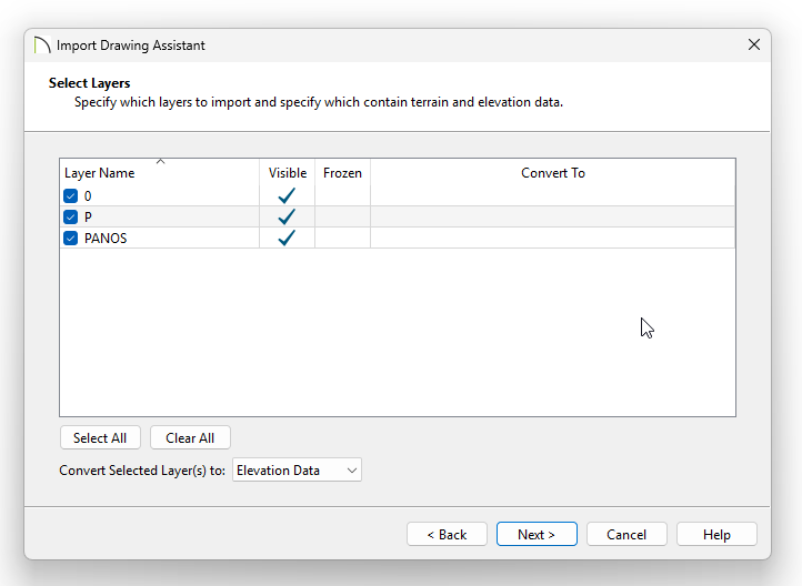

brookesdesign Posted April 6 Author Share Posted April 6 Thanks Michael. I just tried your suggestion (see image) and still nothing. Link to comment Share on other sites More sharing options...

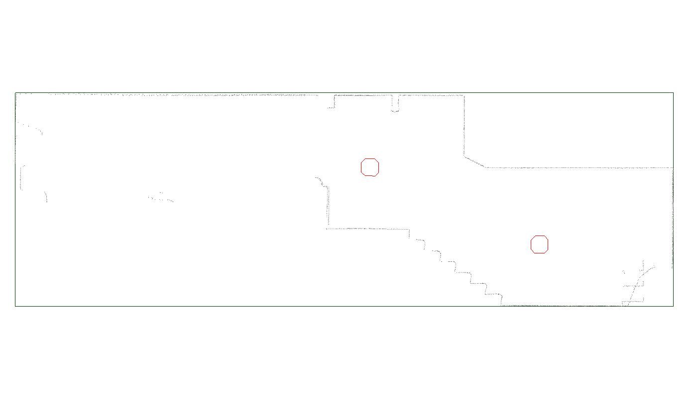

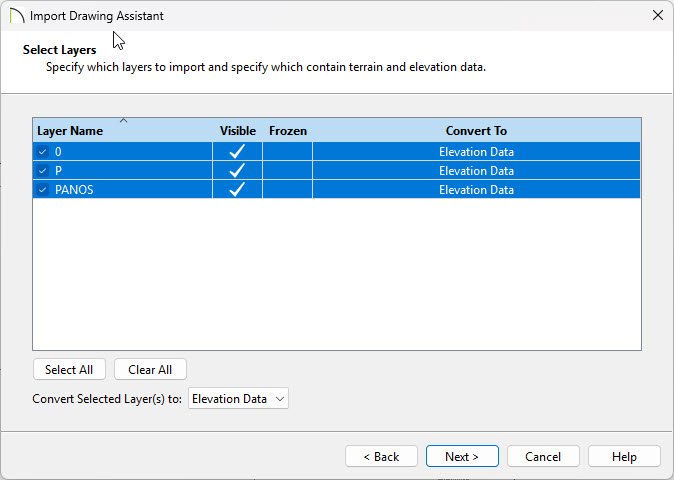

Alaskan_Son Posted April 6 Share Posted April 6 1 hour ago, brookesdesign said: Thanks Michael. I just tried your suggestion (see image) and still nothing. You have to select / highlight the layer before the Convert Selected Layer(s) tool will do anything... Once you do this though, you should get the following import... Its a terrain perimeter with a bunch of elevation points and lines at this stage, but if you create a CAD Detail From View you can get it all into CAD form. Link to comment Share on other sites More sharing options...
