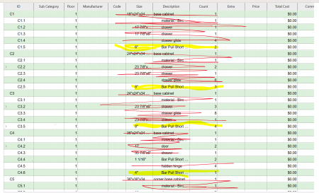

tquade Posted Sunday at 02:13 PM Share Posted Sunday at 02:13 PM Hi all- I've tried all day watching videos for, editing materials lists, looking at schedules and I can't seem to find exactly what I'm looking for? I'm on x15 and we can change the width of the cabinet hardware as needed very easily now (in the dialog box). I'm wondering if anyone out there has figured out how to get only the cabinet pulls/knobs to show up on a material list or schedule or somewhere else I'm not aware of AND the lengths you changed them too? In the picture below I crossed off everything else i don't need. It's super basic so I can't believe I can't do it easily. I can export to a spreadsheet and then make the changes but in my head even that's too hard. Would even love to be able to add the similar styles together. (3 rows that all have 8" sized pulls). I'm hoping that when I update the cabinet plan with the correct hardware pieces, i can just order based on the quantities, too many pieces get missed or double counted by us (phone rings, gotta start over, etc...). Would just be a super nice way to double check. Link to comment Share on other sites More sharing options...
DBCooper Posted Monday at 01:06 AM Share Posted Monday at 01:06 AM There might be a better way, and someone that knows more about the material list might want to chime in, but you could try group selecting all of your cabinets and going into the "components" and just deleting all of the things you don't want. Then when you generate the material list it should just have what you want. Link to comment Share on other sites More sharing options...
