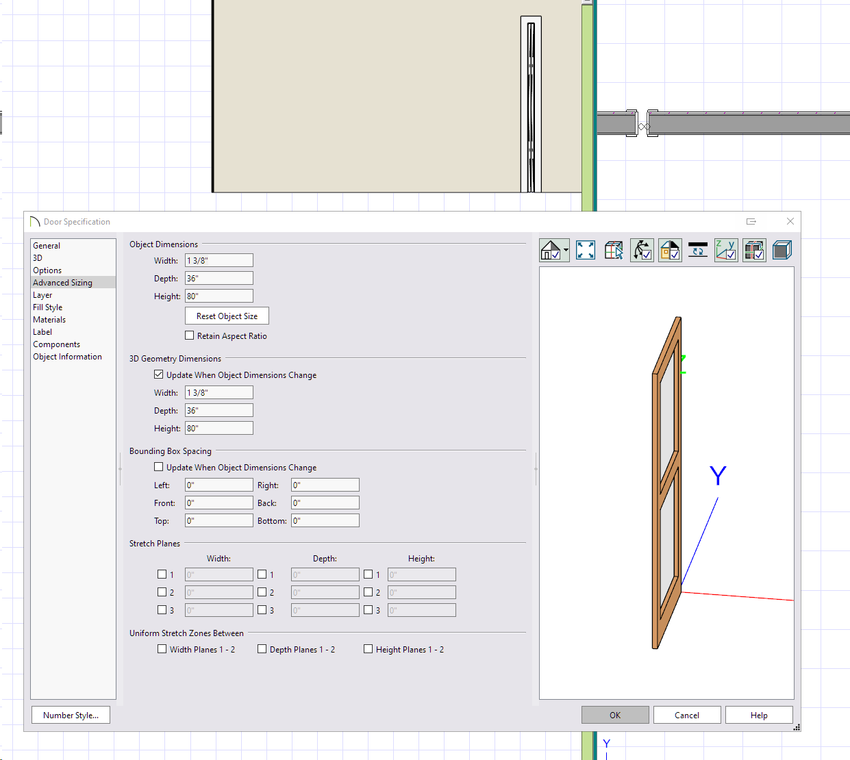

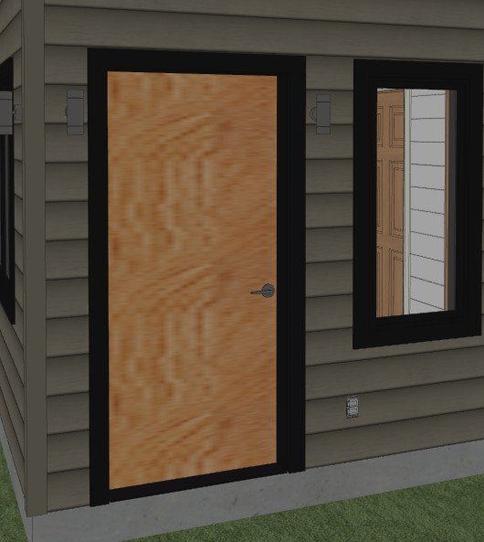

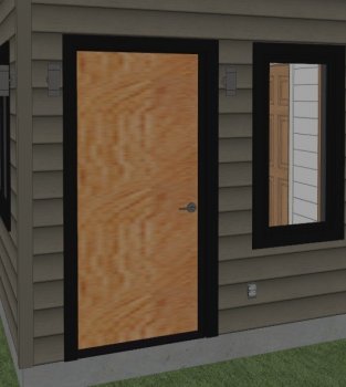

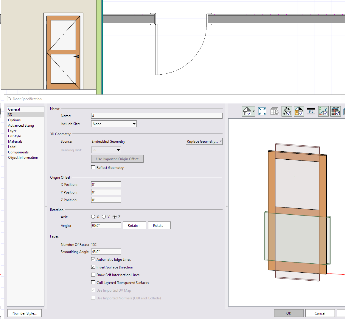

DrawingABlank Posted April 3 Share Posted April 3 I made a custom screen door. Using it from library stretches the stiles. Adding stretch planes helps but still wacky. I tried it in different plan same result. Willing to try it and see if it works for you? Not sure if I should report a bug. Screen Door.calibz Link to comment Share on other sites More sharing options...

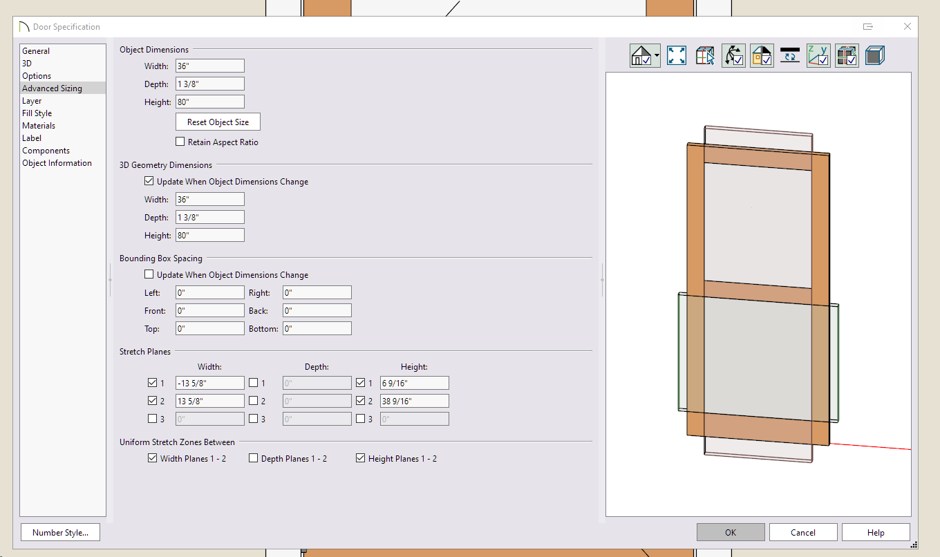

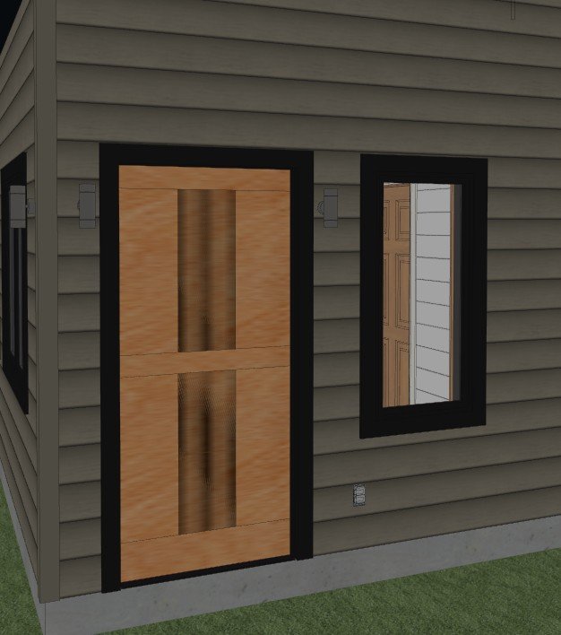

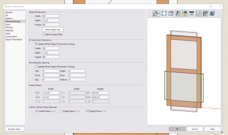

MarkMc Posted Saturday at 11:46 AM Share Posted Saturday at 11:46 AM 17 hours ago, DrawingABlank said: Not sure if I should report a bug Not a bug, pilot error. You need to rotate the symbol 90 degrees on Z axis. Yours looks like this You want something like this. With stretch set to this. NOTE if you want to size both top and bottom you will need to do that in 2 generations of symbol. First change size of bottom, add to library, change stretch zones to the top section and resize. 1 Link to comment Share on other sites More sharing options...
DrawingABlank Posted Monday at 08:30 PM Author Share Posted Monday at 08:30 PM On 4/4/2026 at 6:46 AM, MarkMc said: Not a bug, pilot error. Of course. Thank you Mark for taking the time to reply. Link to comment Share on other sites More sharing options...
