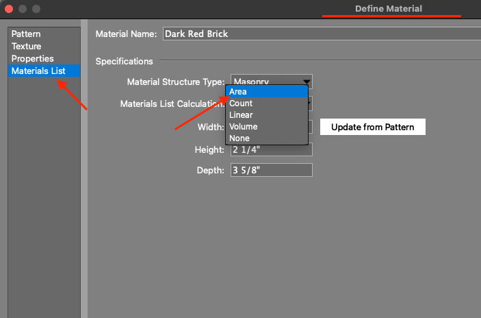

CA_Russell Posted 4 hours ago Share Posted 4 hours ago Hello, If I'm trying to get an accurate indication of how much material 'BRICK' I'm using in my plan, would the correct path be "Create Custom Schedule"? Then is there any assistance you can offer on how to arrive at takeoffs? Its not super clear on which columns to add to arrive at the correct data population. Thanks in advance for your help. Ryan Russell Chief Architect Premier x17 Mac OSX Tahoe 26.4 Apple M3 Pro 36GB / 1TB SSD Link to comment Share on other sites More sharing options...
Chrisb222 Posted 2 hours ago Share Posted 2 hours ago 1 hour ago, CA_Russell said: I'm trying to get an accurate indication of how much material 'BRICK' I'm using in my plan Why not use the Material List? To get it to calculate by Area, go into the Define Material > Materials List panel, and change it from Count to Area: Link to comment Share on other sites More sharing options...
