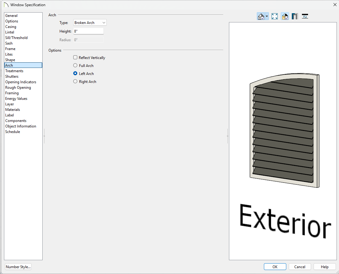

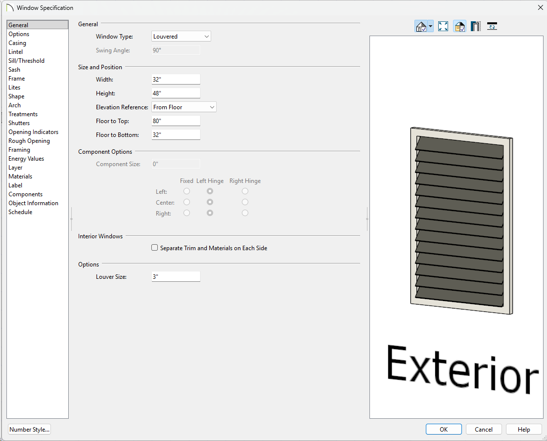

Chief only does exterior shutters out of the box.  For any interior shutters, you will probably have to use blinds or just manually place your own symbols.  I didn't see any in the library that looked very close though.  You might be able to download some symbols from 3D warehouse or even make your own.  I played around with making a shutter symbols using a louvered window and that might be a possible solution.  You can even make an arched one if you wanted.
