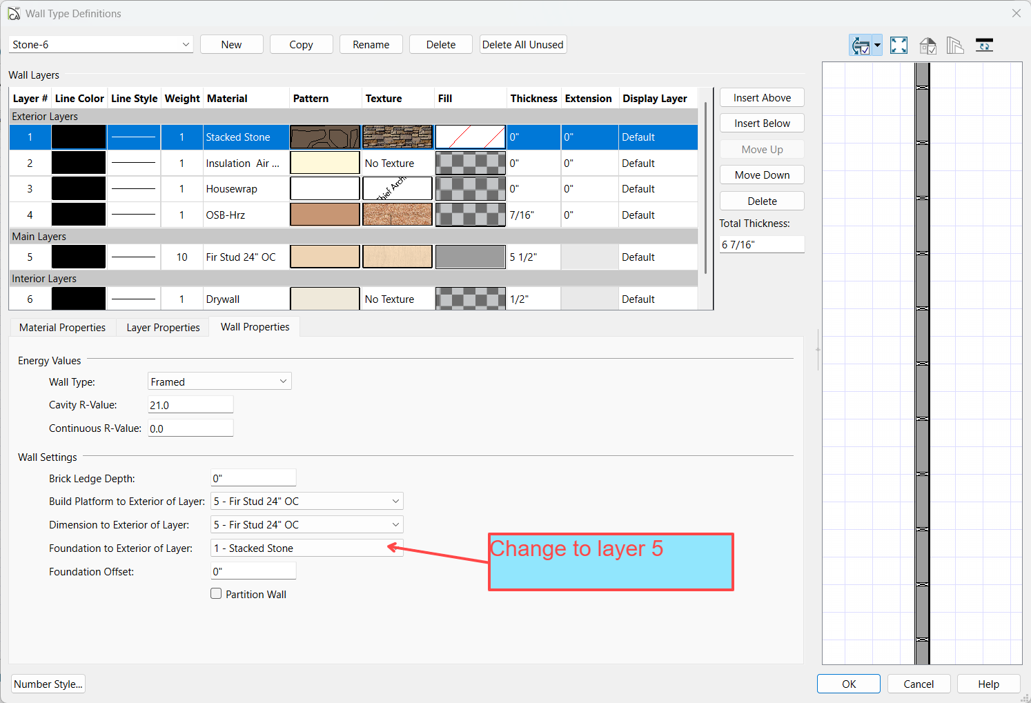

dougbbuilders Posted March 14 Share Posted March 14 Hello, I am have tried quite a few tHaines Plan V2.layouthings to have my main floor wall and my foundation to be the same dimension. It is showing a 1/2 bigger foundation. I believe that I have the wall dimension layer checked. Link to comment Share on other sites More sharing options...

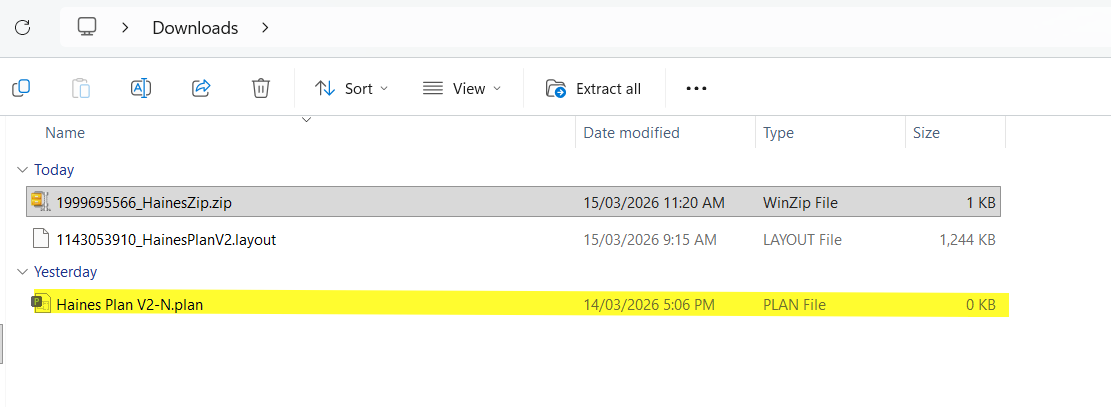

Mark3D Posted March 14 Share Posted March 14 2 hours ago, dougbbuilders said: Hello, I am have tried quite a few tHaines Plan V2.layouthings to have my main floor wall and my foundation to be the same dimension. It is showing a 1/2 bigger foundation. I believe that I have the wall dimension layer checked. You need to share your .plan file not .layout Link to comment Share on other sites More sharing options...
Mark3D Posted March 14 Share Posted March 14 27 minutes ago, dougbbuilders said: Oh ya, sorry about that, I am not sure why it is such a big file, but I hope the Zip file will open for you I think you may have forgot to attach zip file Link to comment Share on other sites More sharing options...
Mark3D Posted March 15 Share Posted March 15 I think you had the file open in chief when you zipped it, as the file has 1 Kb make sure you don't have it open in chief when compressing it, also it may end up being bigger than 14mb after zipping it so you may have to put it on google drive dropbox or other Link to comment Share on other sites More sharing options...
Mark3D Posted March 15 Share Posted March 15 (edited) Its all good don't worry but it still has a problem it must have been open in chief as the plan file has zero bytes size or maybe you attached the same file Edited March 15 by Mark3D Link to comment Share on other sites More sharing options...

Mark3D Posted March 15 Share Posted March 15 If i understand correctly, change setting shown in screen shot then rebuild foundation if i am wrong show me what you need in screen shot 1 Link to comment Share on other sites More sharing options...
dougbbuilders Posted March 15 Author Share Posted March 15 Thank you, that was it! Link to comment Share on other sites More sharing options...
