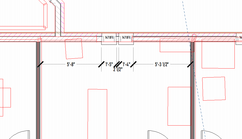

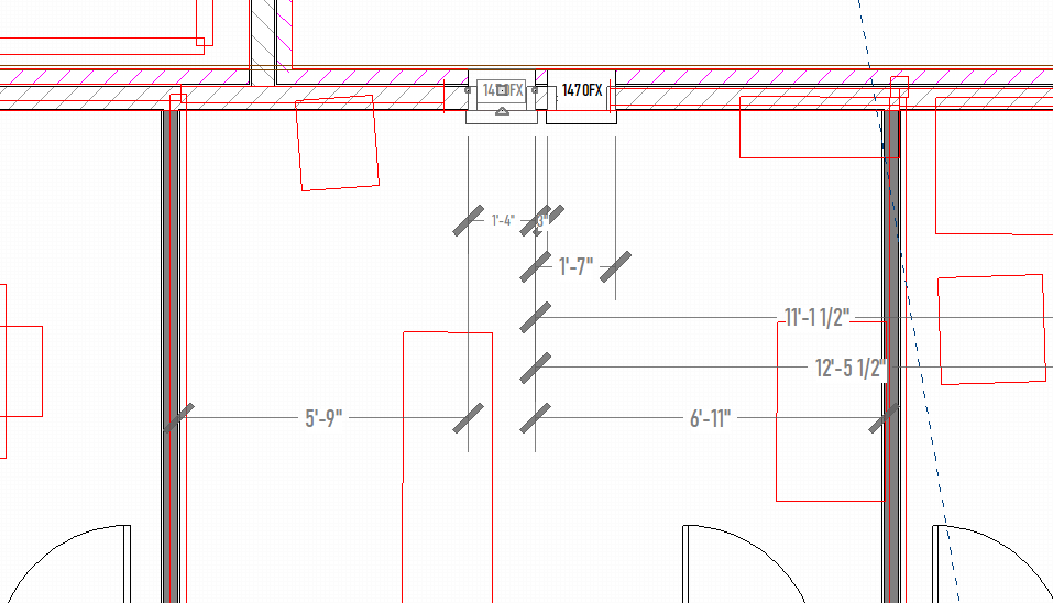

MtGipe Posted 22 hours ago Share Posted 22 hours ago I recently updated to X17. Love the new features to date...except for my inability to get the temporary dimensions to display like I'd like. In X16, when I selected an opening in a wall, the temporary dimensions displayed were running and not baseline. (they showed the dimensions between all items on that wall within the room). Now, in X17 they are stacked and not running....and only seem to go in one direction and not both. Am I missing an easy setting somewhere in the temporary dimension dialogue box to make this setting change? (or is there a tutorial I should watch on the new X17 temp dim functionality?) See attached to help with clarity on the question.... Marshall X17 Link to comment Share on other sites More sharing options...
Chrisb222 Posted 6 hours ago Share Posted 6 hours ago 16 hours ago, MtGipe said: I recently updated to X17. Love the new features to date...except for my inability to get the temporary dimensions to display like I'd like. As of X17, Temporary Dimensions now use settings in the current Dimension Default, under the Setup Temporary panel: There no longer is a single default setting for temp dims. That way you can have multiple setups and switch between them, without having to change them in the Defaults. Link to comment Share on other sites More sharing options...
