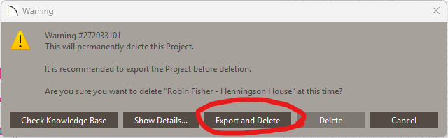

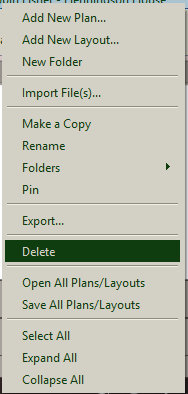

Renerabbitt Posted February 13 Share Posted February 13 12 hours ago, NewLeafHomeDesig said: What is the best way to share files between team members? Do we need to stop using the project management mode and go back to traditional file management with Dropbox? Delete your project in project management It will prompt you if you want to then export to Dropbox I suggest the naming convention260213-DRVA-Briowning-RR where 260213 is Feb 13 2026DRVA is Design Review ABrowning is the job nameRR is the initials of the technician who's version of the file this was is yymmdd-design version-job name-technicians initials If you don't delete the project upon export, that person will essentially have a presumably outdated copy of the project in their project management and also backups will take longer Link to comment Share on other sites More sharing options...

Renerabbitt Posted February 13 Share Posted February 13 3 minutes ago, NewLeafHomeDesig said: Thanks! So it sounds like the project management feature really only works well for situations where only one person works on a project start to finish. Is that correct? no, my entire business is working with other designers and drafters, the above instructions is exactly how I share files back and forth with them Link to comment Share on other sites More sharing options...
