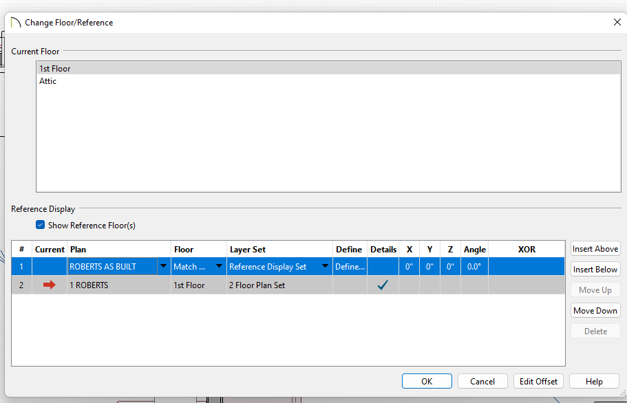

ChiefUserKatie Posted February 12 Share Posted February 12 I frequently overlay As-Built drawings onto my new floor plans using Reference Display, with the As-Built model in a separate plan file. The workflow works fine during the session: I link the As-Built file, set the correct story for the reference, and everything displays as expected. However, when I save the file, close Chief, and reopen it, the reference link is lost. Chief defaults back to overlaying my own model’s second floor instead of the linked As-Built file, and I have to manually relink the external file every time. Is there a way to make this link in the Floor Plan Reference / Reference Display dialog so it stays linked between sessions? Or is this a known limitation of Reference Display when using external plan files? I use this workflow pretty often, so I’m trying to avoid having to relink the As-Built file each time I reopen the project. Any tips, best practices, or alternative workflows would be appreciated. Link to comment Share on other sites More sharing options...
robdyck Posted February 12 Share Posted February 12 Are you using Saved Plan Views? Link to comment Share on other sites More sharing options...
