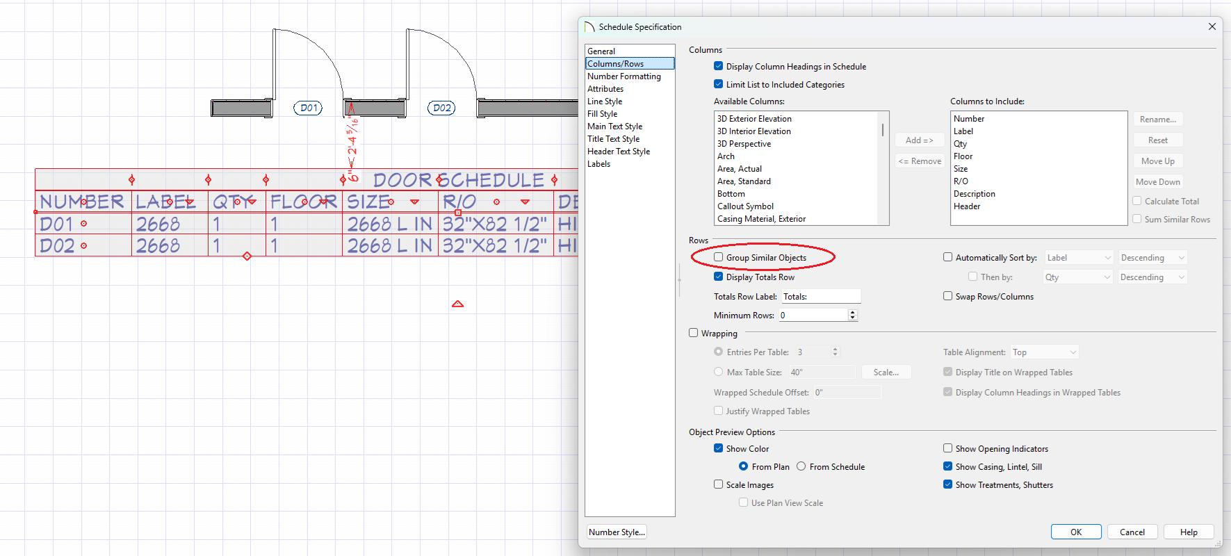

MuseDesigns Posted February 5 Share Posted February 5 I'M WORKING ON A DOOR SCHEDULE. IS THERE A WAY TO SEPARATE THE DOORS SO EACH DOOR HAS ITS OWN DOOR NUMBER? JIMMY MUSE MUSE DESIGNS Link to comment Share on other sites More sharing options...
DBCooper Posted February 5 Share Posted February 5 (edited) Open the schedule dialog and turn off the "group similar objects" option. Also, just as an FYI, objects in schedules are always grouped according to the text that is shown in the schedule. So depending on what columns you have turned on, you may get objects that are grouped together that you don't want grouped. You can always add columns to show data that is different, sometimes even just notes, to get your objects on separate rows. Also, just as another FYI, best to post your general questions in the Q&A forum instead of the sales or chatroom (and you should only need to post it once). And the use of all caps is considered yelling in online forums so most people prefer normal case. Edited February 5 by DBCooper Link to comment Share on other sites More sharing options...
