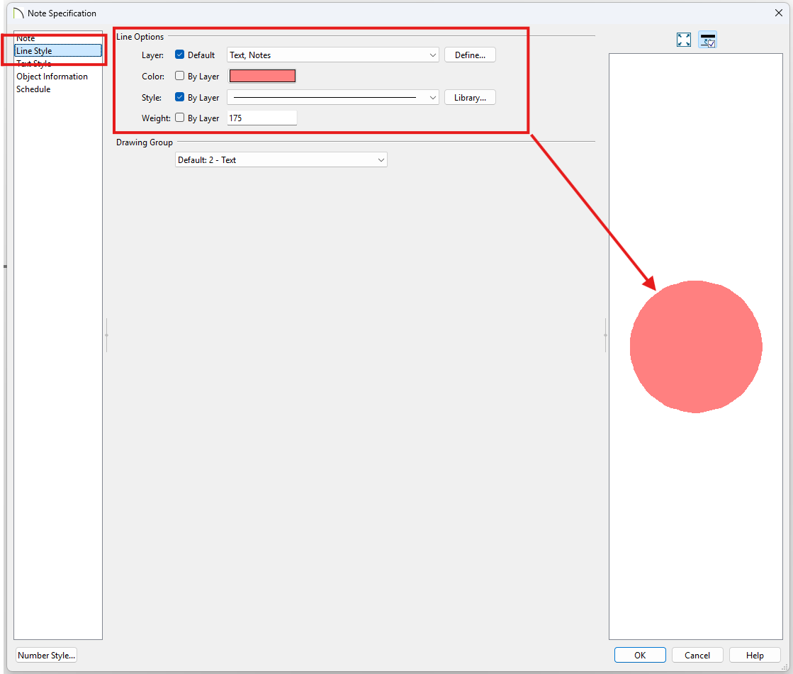

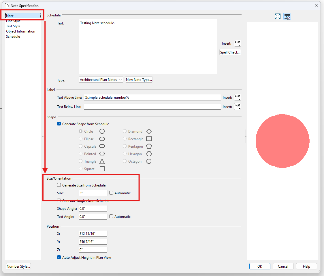

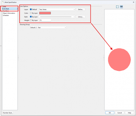

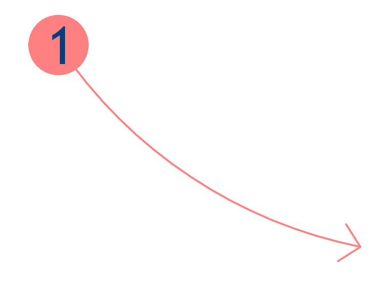

JonathanK Posted February 4 Share Posted February 4 This is a major work around, and will not look good on your plan with line weights off, but looks fine printed and with line weights on: Open the note you want to change. Go to "Note" Change the size to something like "3". Or whatever small arbitrary number you'd like. Go to "Line Style" Change the line style to whatever color you want. Change the line weight to something that fills the circle. I'm sure the others have a thought on this... 1 Link to comment Share on other sites More sharing options...
