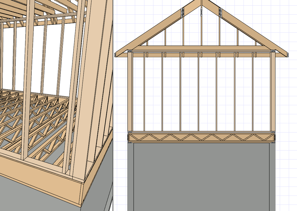

Chrisb222 Posted February 1 Share Posted February 1 2 hours ago, DQUser said: I've double and triple checked my settings and can't find where it might be pulling in information that is causing the i-joists. Works for me. Since you say you've checked your settings, you must be missing something. 2 hours ago, DQUser said: can't get it to show correctly in the section cut. Are you using a layer set that shows framing members? Did you rebuild framing after changing any settings? You would get a quick accurate answer if you posted the plan file, instead of guesses. Out of the box X17, with proper framing and display settings: Link to comment Share on other sites More sharing options...
