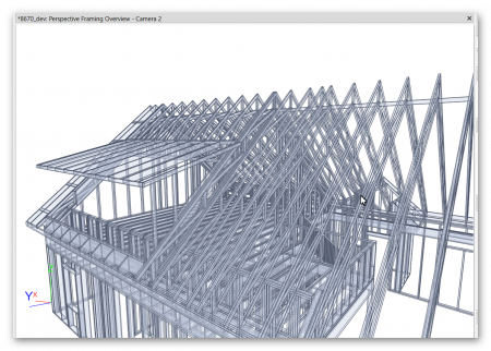

Mitchellopolis Posted 11 hours ago Share Posted 11 hours ago The auto dormer feature worked great when my plan called for rafters, but when I switched to trusses it didn't play so well. The current plan calls for parallel chord trusses. There is a vaulted* ceiling toward the front of the cabin and a loft over the back half with an 17' wide shed dormer. The dormer should meet the 8' ft ceiling of the loft. Any tips on how to use auto dormer with trusses? The dormer location is included in working plan view if anyone wants to dig in. Also, Chief did some pretty wonky framing of the entryway. Any ideas about how to clean that up would be appreciated. Thanks in advance for any advice. * semi vaulted. There will be an eight foot ceiling in the loft that extends through the great room. 8670_dev.zip Link to comment Share on other sites More sharing options...
Mark3D Posted 5 hours ago Share Posted 5 hours ago I am no expert on this, but I selected rafters then build auto dormer and after that I reselected trusses, seems to work. Link to comment Share on other sites More sharing options...
