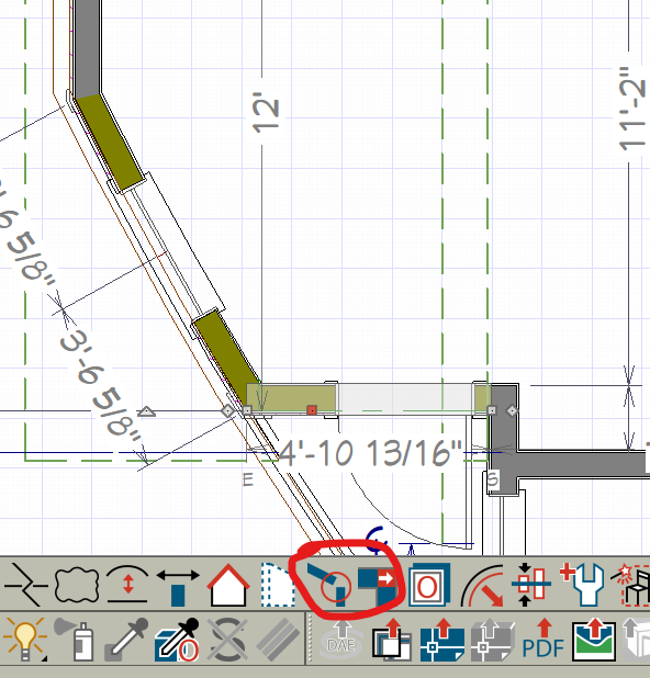

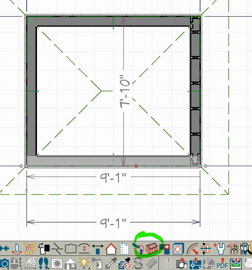

Hello, I have a house I'm designing and when I select a wall the option to build framing is missing.  On the left is a new plan and when I select a wall the option appears (circled in green)  But in my current plan, the option is missing (circled in red.)
image.thumb.png.5c30e2012e033b0b997e7f4ddd214c86.png  image.thumb.png.129da3641d642f150cb6598ff7456bcb.png
Any insight would be greatly appreciated.

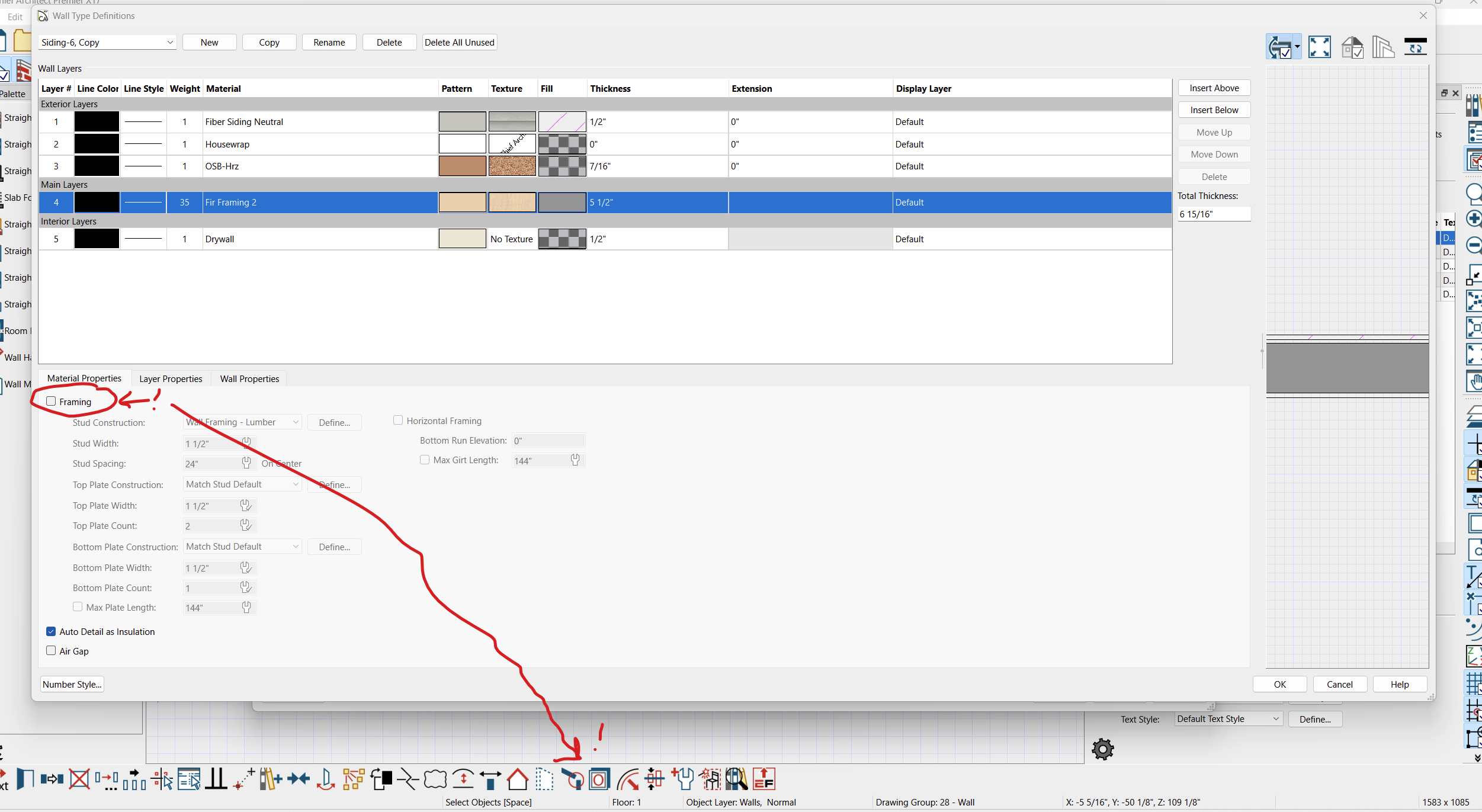

John,
Does your main layer have framing option turned off?  I did an experiment where I made a copy of an exterior stud wall and then turned off the framing feature.  That killed the framing option for the particular wall type as there's nothing to frame:
Jim
